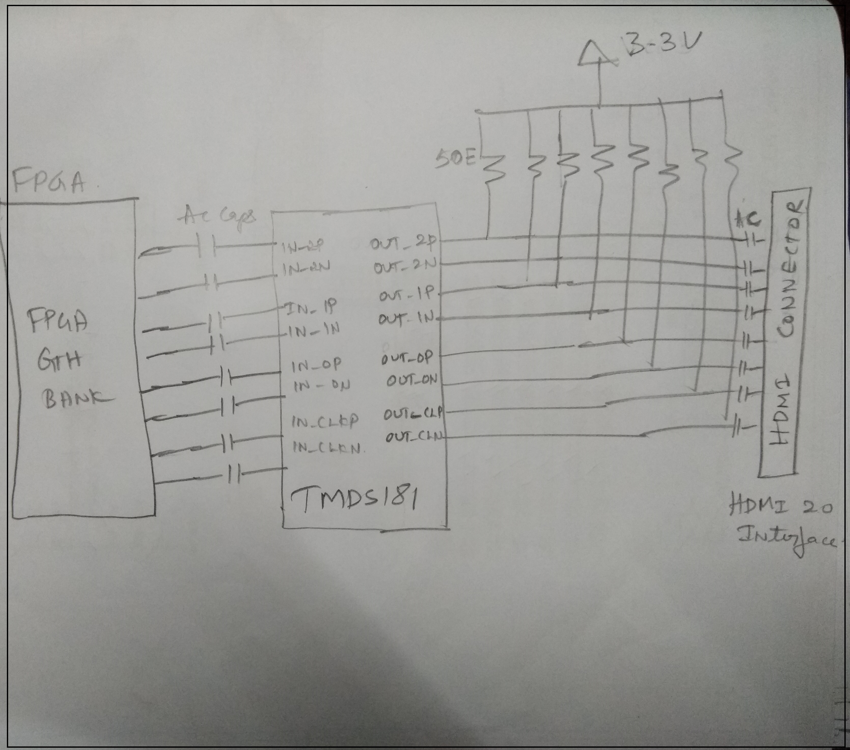

    In the above Block diagram, I have interfaced TMDS181 Retimer between FPGA and HDMI Connector.
    I have connected AC caps between FPGA and TMDS input channels and 50E pull up resistor and AC caps at the output channels to HDMI connector.
    I just wanted to clarify this circuit design is proper or not. if it is wrong please correct it.
    Thanks & regards,
    Divya
  • Hi Divya,
    The TMDS181 device requires standard TMDS inputs, it cannot accept AC-coupled inputs.  The SN75DP159RGZ is a better choice for an application that requires AC-coupled TMDS inputs.  Also why would the TMDS outputs to a standard HDMI connector be AC-coupled?  Is this a custom connector?

    Thanks for the information.
    In application of FPGA (source) to HDMI Dispaly (Sink)
    I have planned to use AC Caps at the TMDS181 inputs because it does not satisfy common mode input voltage requirements.
    At FPGA side Common mode output voltage  VCMOUTDC =2.05V, whereas in TMDS181 Common mode input VIC=2.9 (MIN)
    Please suggest how can i proceed ???
    In application of HDMI Display (Source) to FPGA (sink),
    i don't know about the Common mode output voltage at HDMI Display side. At the output of TMDS181 to FPGA i can place AC caps near to FPGA GTH pins (internal biasing enabled) so that we can achive common mode voltage range at FPGA side.
    Above my thought is correct or not ?
     SN75DP159RGZ : Can i use this part for my above 2 applications ??? FPGA (source) to HDMI Dispaly (Sink) and HDMI Display (Source) to FPGA (sink)
    Please suggest me.
    Thanks & regards,
    Divya
  • Divya,
    Please check with the FPGA manufacturer on the requirements for FPGA source to HDMI sink.  If the FPGA requires AC coupling, use the SN75DP159 device.
    The outputs of the TMDS181 or SN75DP159 are standard TMDS outputs.  This means that there must be 50 ohms to 3.3V for current sourcing.
    JMMN

  • Hi Divya,
    Since you have two different applications, you need to use two different redriver/retime devices. The EVM User's Guide for each device has a reference schematic.
    SN75DP159 is designed for AC-coupled TMDS inputs to standard TMDS outputs.
    TMDS181 is designed for standard TMDS inputs to standard TMDS outputs.
    JMMN
