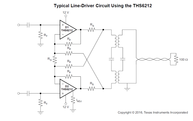

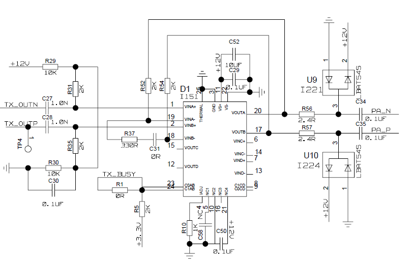

Is there any offset in the input port of THS6212 chip D1IN+ D2IN+?We want to eliminate the external bias resistance and bias voltage capacitance, thank you!
Hi Wang,
Yes. Any op-amp will have some type of DC offset at the input. Please refer to section 7.3.5 in the THS6212 datasheet for further details on calculating the output offset.
Rohit
