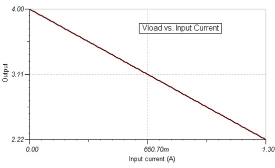

    You are correct.  The worst-case error will occur when the load current is smallest.  We wrote an article series at http://www.eetimes.com/design/industrial-control/  Accuracy is discussed in Part 3, which was published yesterday.  How timely.
    The tradeoff with respect to the sense resistor is the voltage drop at maximum load current versus accuracy at minimum load current.  With a 1.3A load current, a 1.37ohm sense resistor will drop voltage such that ~2.2V will be available to your load.  Here is a graph of the voltage supplied to the load vs. the load current for the 1.37ohm sense resistor:
    If we decrease the sense resistor value we will provide more voltage to the load at the cost of accuracy at minimum load.  Changing Rsense to 1ohm will allow for 2.7V to the load.
    So, the question becomes:  what is the minimum voltage that your system can tolerate?  This will help determine the maximum sense voltage.
    In this type of application (cell phone test bench), however, we have seen cases where you may have control over the common-mode voltage.  In other words, you may be able to increase the 4V supply to essentially offset some of the sense resistor voltage drop.  Additionally you may also have room to increase the gain of the INA, thereby allowing you to use a smaller sense resistor.
    I hope this helps!

    Thanks for your quick answer and the link to the article accuracy, really well written and clear. There is a last thing that I did not fully understand. When the input current is 1.3A, the resistor will leave around 2.2V for the phone as you said. Does this mean that the phone will switch-off due to lack of voltage supply? It needs around 3.7V.
    I think that the minimum voltage that my system can tolerate is around 3.7V, which means that with 4V I should use a small resistor that creates a Vsense of 0.3V max. Is that right?

  • Hello Ehkiotz,
    No problem...I'm glad you enjoyed the article!  Your understanding of the sense voltage/system voltage vs. sense resistance vs. error is correct.
    I don't know exactly what will happen to your system if it requires 3.7V and is only supplied with 2.2V.  The best solution here is to ensure that your shunt voltage is <300mV as you correctly pointed out.  Similar to a minimum system voltage, is there a maximum system voltage?  For example, if the system can tolerate a supply voltage of 3.7V-4.3V, you really have 600mV to work with if you can easily increase the system supply voltage.
    I would size the shunt resistor for the 160mA setting such that the 160mA is in the center of the expected range.  I do not know what that range is, but you now have a solid understanding of how to translate this range to a shunt resistor based on all of the variables.
    Since your shunt voltage must be <300mV (assuming you can't increase the system voltage), you will be required to keep your sense resistor below 230mohms at maximum load.  At minimum load (1.4mA) this would correspond to a shunt voltage of ~300uV.  If you wish for 10% error, you will need an amplifier with 30uV of input-referred offset voltage.  We do not have any instrumentation amplifiers with such low input-referred offset voltage (the INA333 is the closest, but you may have supply/output voltage issues), so you will have to perhaps tolerate more error or see about raising the system voltage to offset some of the voltage drop (if feasible).  Or, you may consider using multiple devices (e.g. an INA210/1/2 for the minimum current measurement and a different device  for the rest of the measurements).  Also, there are some devices whose gain can be changed digitally (e.g. PGA280).  I have not thought much about this solution, but it may be the way to go here.  Finally, as you already mentioned, perhaps you could calibrate out the initial input offset voltage(s).

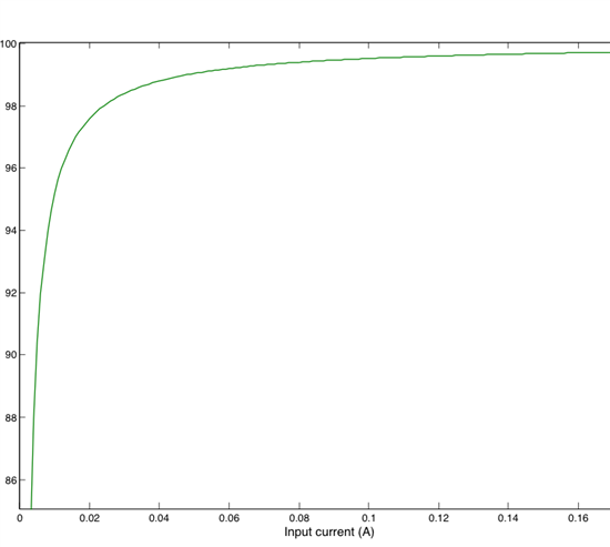

  • Hi!
    Finally I finished the following circuit that would allow the phone to have 3.7 V (Vloadmin) based on your previous design:
    I also calculated the error due to the offset voltage and the CMRR:
    And I will calibrate the error based on measurements using different Rload resistors.
