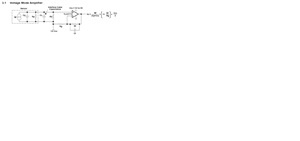

Signal Conditioning Basics for ICP® & Charge Output Sensors :
Does this circuit meet our purpose ?
    The circuit schematic that you show is a charge amplifier which is commonly used for un-amplified charge output accelerometers. The sensor that you have linked to is internally amplified and only needs a voltage source in series with a current regulating diode as a power supply and op amps are really not needed for the power supply. This is shown in Figure 7 of your second link.
  • Thanks for your answer, but is it possible to design a current source with opamps(excluding these diodes) ?
  • Is it possible to use something like this?
