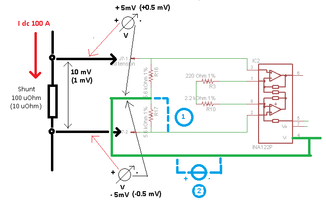

Hi, i have trouble measuring low voltages (0 to 100mV) with INA122.
As input, I have several shunts (some are copper bus bars) with different values and 100A full rectified (pulsating 100Hz, not filtered) passing through them.
With the INA122 I measure the voltage drop across them, and then get their value in micro Ohms.
So, I am measuring 0-100mV full rectified (not filtered) with INA122, after the IA I have 2 Sallen Key filter i series to get the "mean value" then to the microcontroller ADC.
The input is a shielded twisted pair (I have 100A (100Hz) and their noise in the same box...), I have 2 5k6 1% resistors from both inputs to ground, the INA122 is powered single supply 24V, and then a voltage divider to the sallen key filters. Also I have the reference pin (5) with a trimmer to adjust voltage reference.
Gain resistor are 2k2+220 1% (gain approx 87).
I cant get values to repeat, or to be consistent. I recently read about (V-)+0.15, so I´ll change gain resistors.
Any help would be great

  • IMHO, what I would point out is that the input circuit is working beyond  of the Input Common-Mode Voltage Range.
    Please look at the following schematic
    Let's assume
    Shunt: 100 uOhm
    Shunt DC current: 100 A
    Voltage across the shunt: 10 mV
    I we measure the voltages (referred to GND - heavy green line - pin 4 of INA122) at the 2 inputs of INA122 we get:
    pin 3: +5 mV
    pin 2: -5 mV
    Voltage at pin 2 (negative) is out of Input Common-Mode Voltage Range as spec'd in the data sheet of the IC
    If you have a "100A full rectified (pulsating 100Hz)" current in the 100 uOhm shunt which are the peak voltages at pins 3 & 2?
    Assuming roughly 150 Apeak current we get:
    pin 3: +7.5 mVpeak
    pin 2: -7.5 mVpeak (out of IC specs)
    I propose 2 solutions (one of the two dotted ligth blue line)
    1) Short circuit R17: this way the Input (Common-Mode) Voltage at pin 2 goes 0 (zero).
    This way the imbalance of the circuit is minimal as pin2 & 3 are "short circuited" by the shunt (100 uOhm)
    OR
    2) (Better) "Rise" R16 & R17 from GND (pin 4 of INA122)  inserting a "few volts" between GND and the R16 & R17 "common point"
  • Thanks, I´ll try the second (I have some 3.3V in the PCB near).
    I dont think the first option would work in my circuit because I have next of the shunt, a Hall efect IC to measure current, and then the ground of the "power circuit" is attached to the ground at PCB.

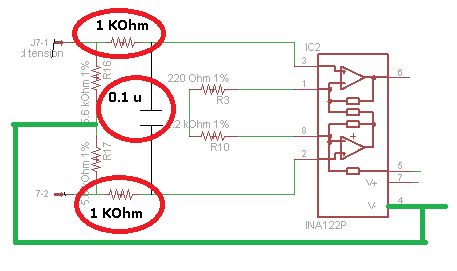

  • Hello Martin,
    thank you for your appreciation
    If I may make an addition I suggest to add a low pass filter in front of the INA122 in order to cut the noise, as in the following schematic
    2 x 1 KOhm and 0.1 uF
    Martin Rodriguez51 said:
    Marco I tried rising R16 and 17, but got better results with the dual supply. Nonetheless I want to thank you for your answers.
  • I´ll try it and let you know.
    Thanks!
