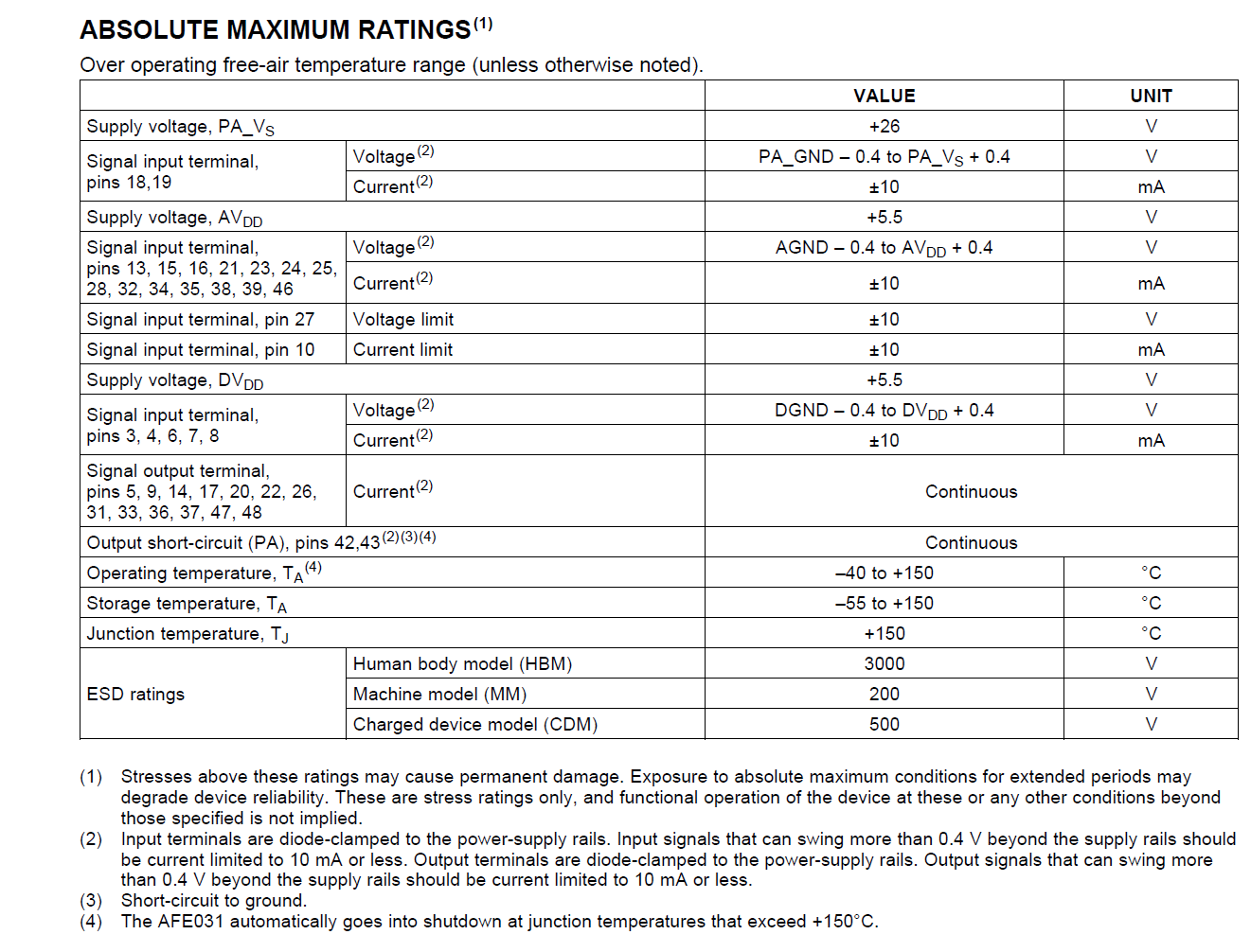

I would like to know the failure conditions for AFE031. We have matched the circuit and taken all necessary precautions but here is till some failure. Please can you the possible reasons for failure

Hello Nidhi,
Could you please elaborate on what you mean by “we have matched the circuit” and “here is till some failure”?
Jose
Hello Nidhi,
In most cases, exceeding the absolute maximum ratings of the AFE031 (see page 2 of its datasheet) causes damage to the device.
Jose
