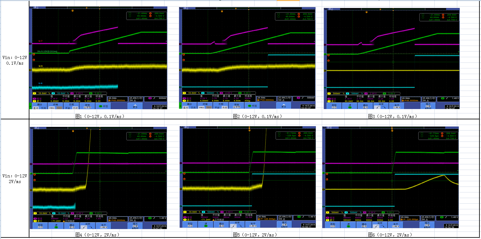

  Could you help check below question from the customer about LM2903D?

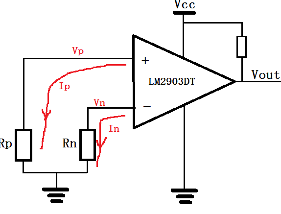

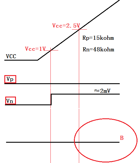

   When VCC power up from 0V to 12V with 0.5V/ms ramp rate in below circuit(Rp=150k,Rn=8.4k),there is a pulse at the output during power up.
If change the Rp=15kohm and Rn=48kohm,then there is no pulse during power up with same ramp rate as below.
When Rp=150k,Rn=8.4k,there will be a pulse during power up if the ramp rate slow than 1V/ms. There is no pulse when power up ramp rate>2V/ms.
Could you help check why there is the pulse during power up in different condition? And why the output pulse is relate with power up ramp rate and the resister value?
