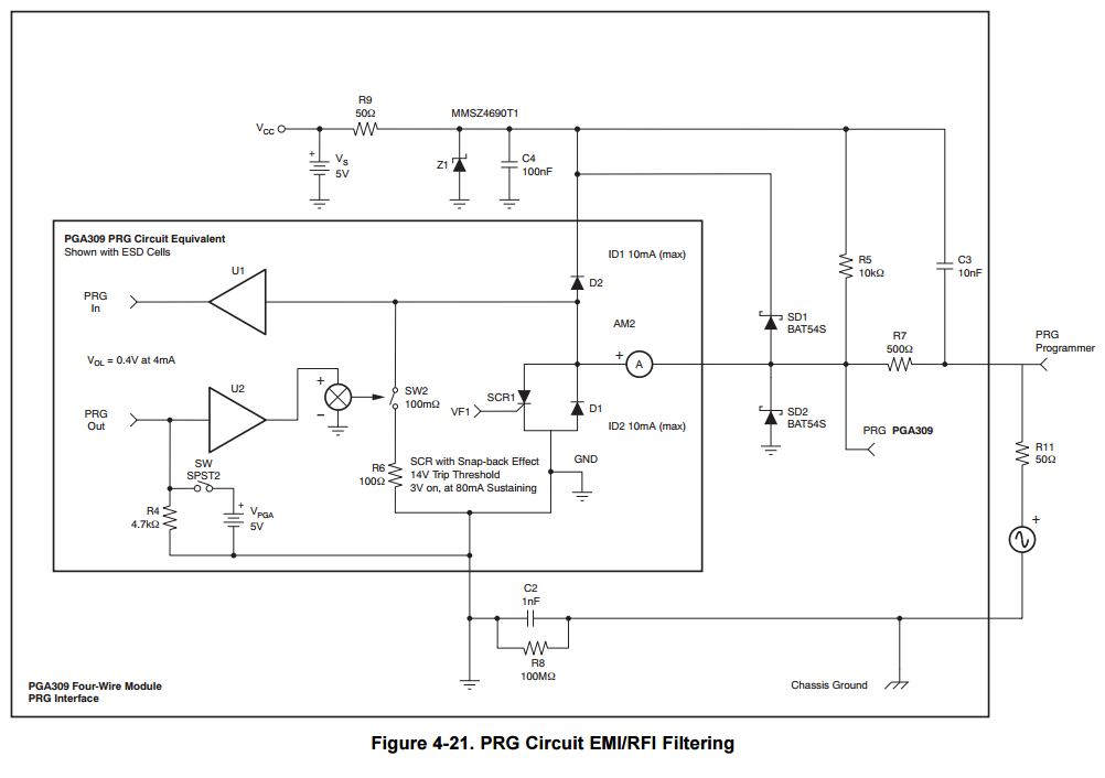

    Q3: Again, the PGA309EVM-USB software does not support I2C mode. Only one-wire mode is supported. If the customer uses one-wire mode to communicate with the circuit, I recommend following the schematics from the PGA309 User's Guide, copied below. Please note that the required connections change depending on whether 4-wire mode (PRG separate from VOUT) or 3-wire mode (PRG connected to VOUT) is used.

    Q2: If the customer wants to use one-wire mode, he should refer Figure 4-15 of PGA309 User's Guide, right?
  • Hello Mickey,
    Q1: If the customer wants to modify the registers value directly, the TEST pin should be high. However, the TEST pin can also be kept low and the EEPROM can be written. When the TEST pin is low, the PGA309 reads the EEPROM every few milliseconds and updates its registers.
    Q2: If the customer wants to use the 1W interface and a 3-wire module, with VOUT connected to PRG, he should refer to Figure 4-15. If he wants to use the 1W interface and a 4-wire module, with VOUT and PRG separate, he should refer to Figure 4-21.

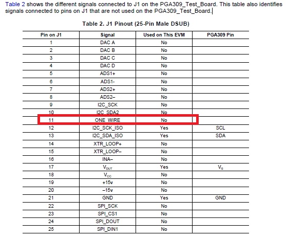

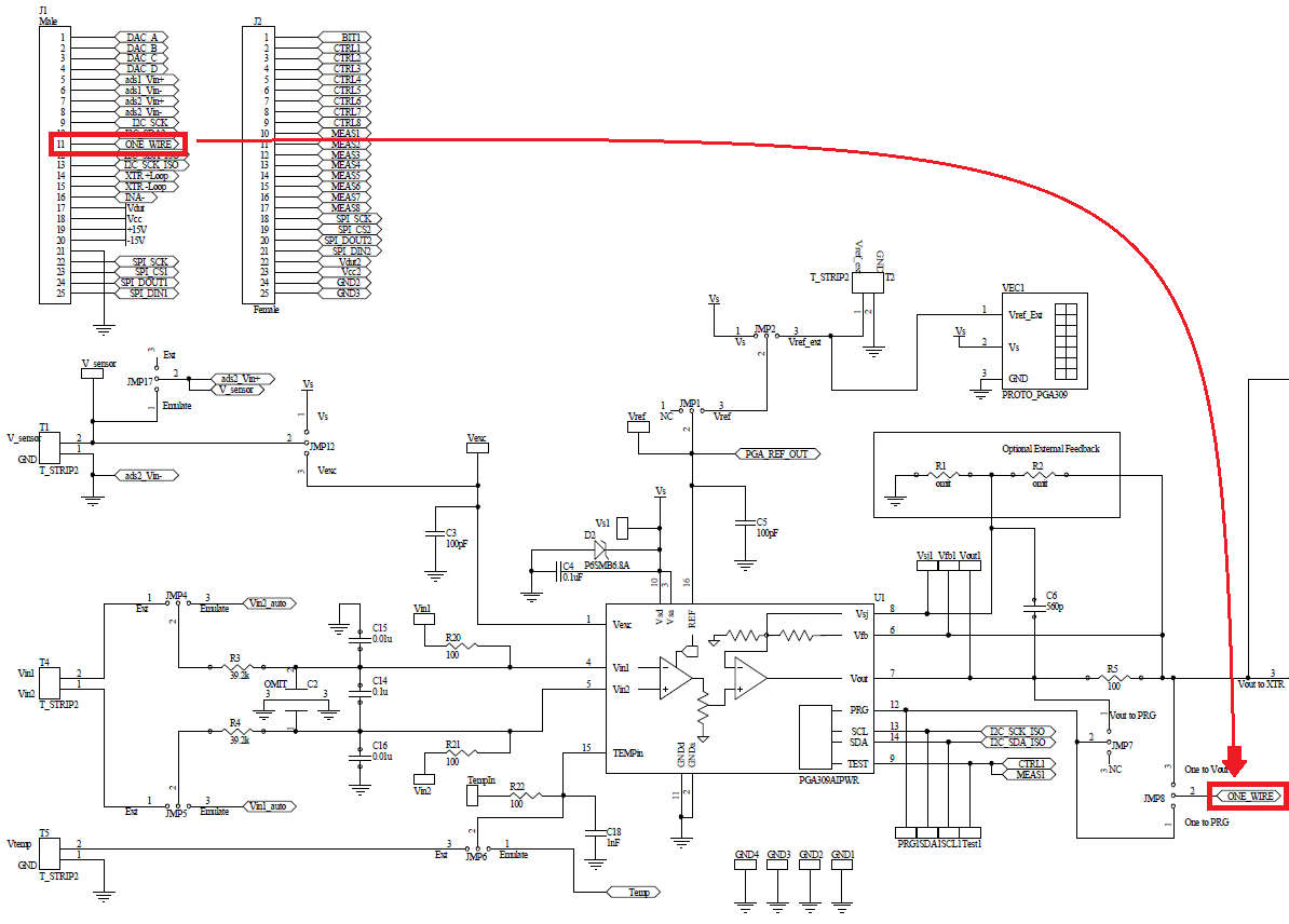

    Q1: The customer has another issue. He uses PGA309EVM-USB and he found one-wire is not be connected in the EVM board from sbou084a. Look the attachment.But you tell me the PGA309EVM-USB only supports one-wire operation. So which interface is used in the  PGA309EVM-USB board?
    Q2: However, I can not find sbou084a  document on TI website and I also can not see the PGA309EVM-USB on TI website now(8/25).  I still can see PGA309EVM-USB and  sbou084a  document on TI website a few days ago. What is happened?
  • Hi Mickey,
    Q1: The PGA309EVM-USB uses the one-wire interface. That table is incorrect. Please see the PGA309EVM-USB schematic, partially copied below. Pin 11 of connector J1 connects the ONE-WIRE signal from the USB-DAQ platform. The ONE-WIRE signal connects to the PGA309 PRG pin depending on the position of jumpers JMP7 and JMP8.
