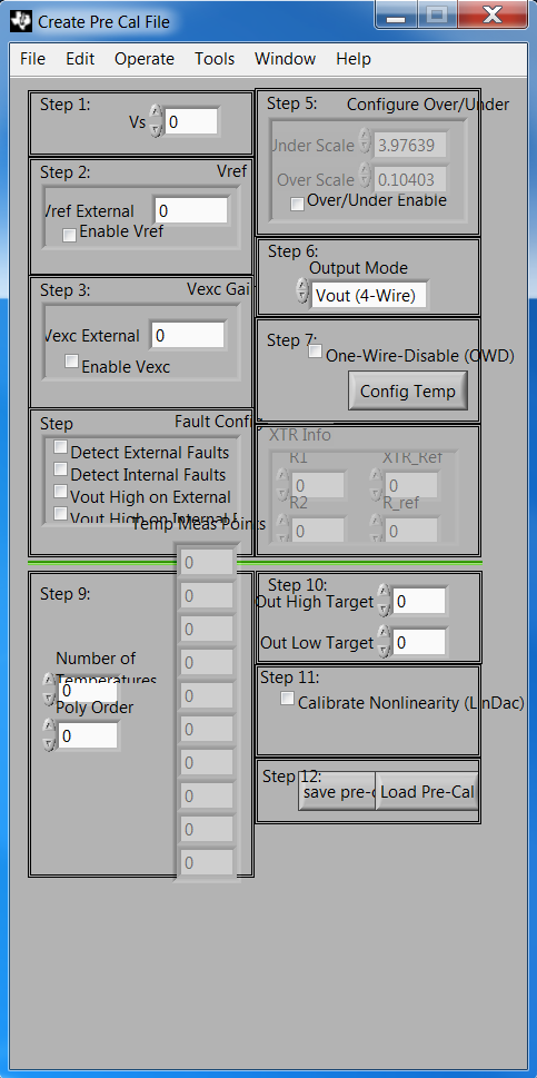

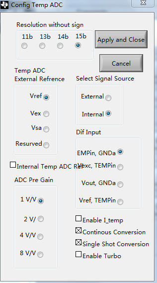

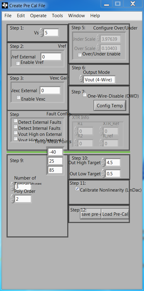

The customer is using PGA309EVM-USB.  There are some issues when the customer calibrates the parameters.

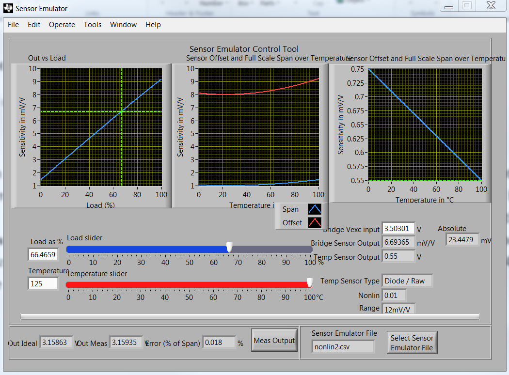

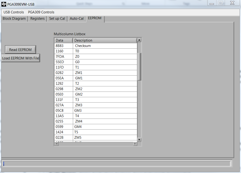

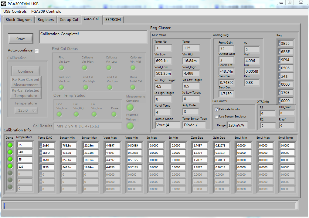

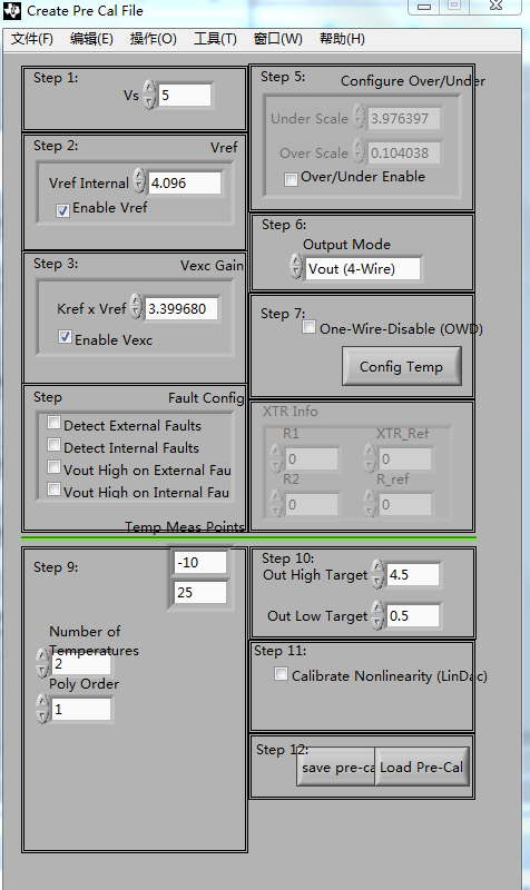

The customer calibrates 3 ponits, those are 25℃, 85℃and 125℃,  the output  voltage is normal and the voltage is from 0.5V to 4.5V. And the
configuration for EEPROM is as follows.

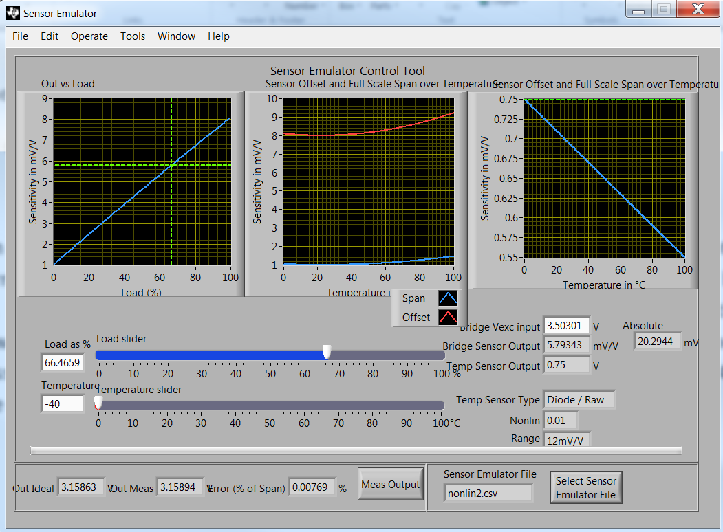

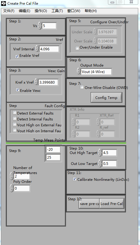

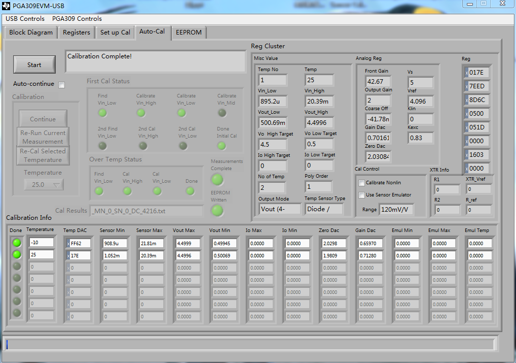

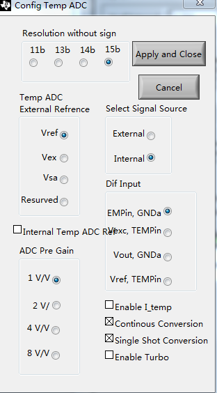

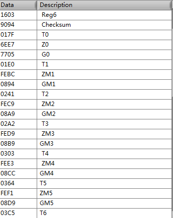

However, when the customer calibrates another 3 ponits, those are -40℃, 25℃,and 125℃ or -40℃, 25℃ and 85℃
,  the output  voltage is only from 0.56V to 4.3V. And the T1~T5 registers for EEPROM  are 0. The configuration for EEPROM is as follows.
Q: What is the reason? How to solve the issues?
