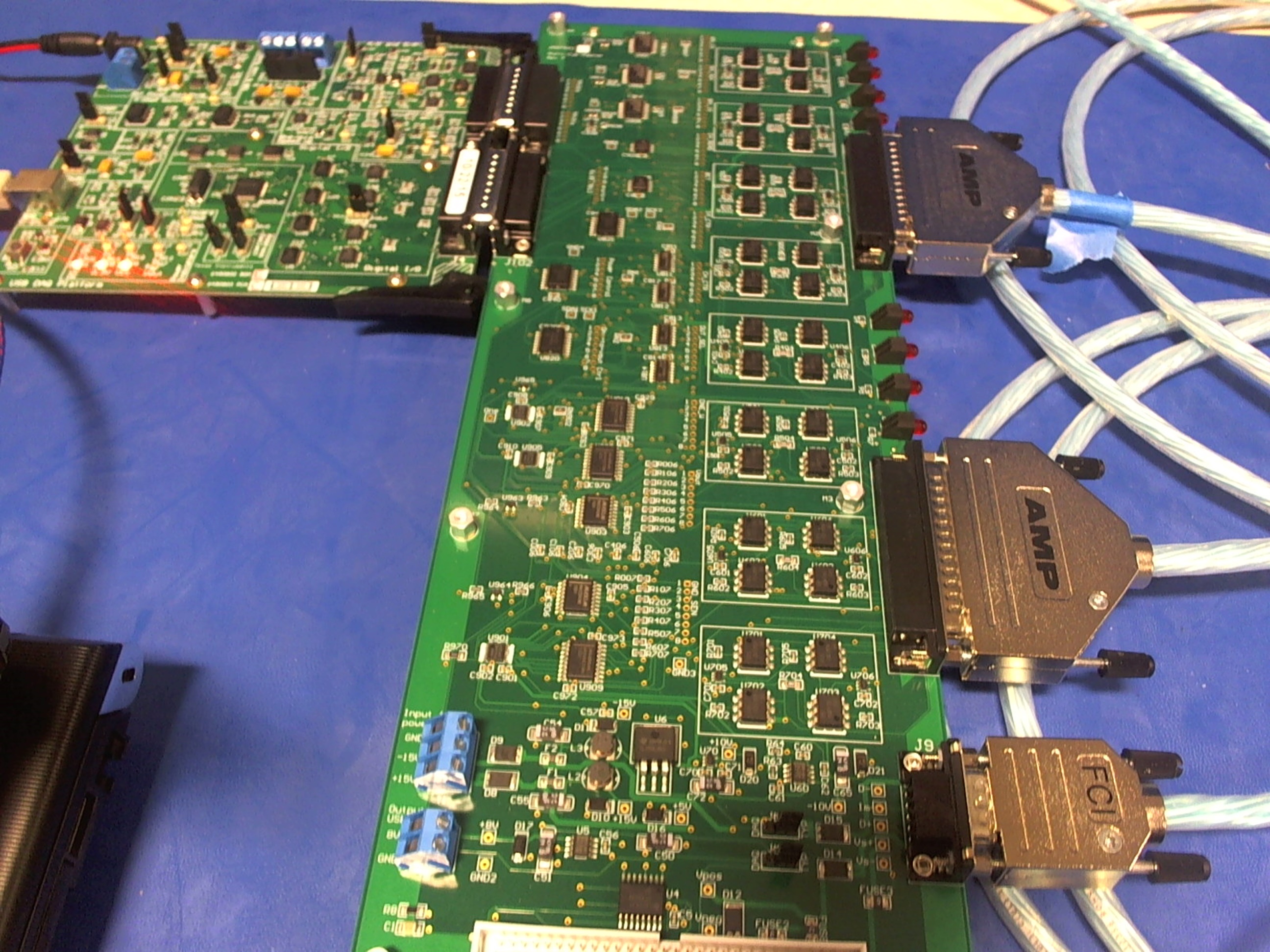

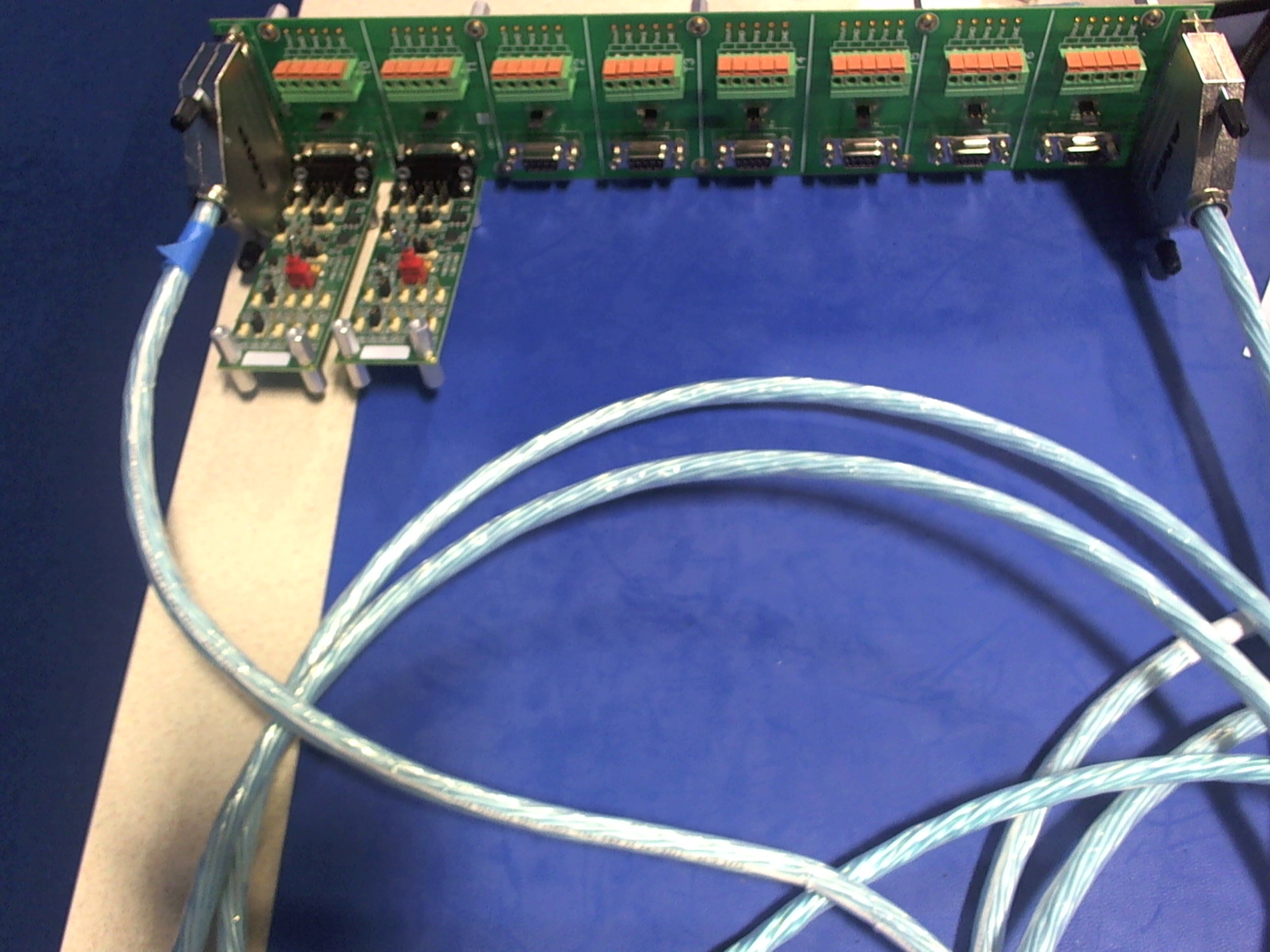

I have a DAQ board connected to a multi-cal master board with two PGA0308 evaluation boards on the interface board.
All cables seem correct
I have them set for 4 wire voltage mode, and I select the 4 wire voltage mode model in the software.
my supplies are on, the +9V to the DC jack, the USB is plugged in, the
15/-15V and 5V that supplies the DUT and these are supplied to J9 on the multi-cal master PCB
Under the debug tab, I play with the mux setting, and the corresponding  LED's light up, and under the debug tab I can affect dut power LED on the DAQ board with the GUI switch.
but when running the "test" or the "calibration" TAB my modules always report in the window "communications error"
I can't find a full schematic to the multi-cal master board, only the user manual.
When under the debug tab, I select the mux and the LED lights. but  the opto-relays on the slave do not pass
DUT power (+5V) to the DUT's (my PGA0308) module.  The LED side of the opto's are not being brought to ground to turn the
opto relays on.
I am suspicious that the I2C or something else isn't working.  I have not yet gotten out my scope to start probing I2C local to the DAQ board (hey it's the weekend!)
But I am sure something is simple wrong that I am over looking, a jumper setting someplace?
Also, is there a power supply sequencing that is recommended?

  • Right out of the box, I decided to try the 4 wire model from the EVM software , no Power supply script,
    so I turn on the +/-15V and the 5V which leads to UUT power manually and then run the calibration,
    but these modules never reply; communications error is all that I can get on the calibration line for any module.
    I am not sure if the UUT is getting powered or not; if it is not then it will not answer via the OTP
    I did not get a chance to scope the UUT's power rails at the opto-relay today.
    I will tomorrow.
  • Hello Brett,
    Thank you for sharing these images. When you attempt a calibration using one of the standard model/pre-cal files, does the "Vdut" LED on the USB DAQ Platform PCB ever illuminate? This indicates that the +5V/3.3V supply to the PGA309 is on, and without it the device can not communicate.
    There's no critical power supply sequence, just make sure the +5V bench supply, +/-12V bench supply, and 9V wall wart supply are all powered on.

  • Yes it does.. it's interesting though, the led does not shut back off. I looked at the USB "Debug" window and it looks like the slave board I2C are Acking back. I am going to start from a fresh of the install in case some how the model was modified (I am new on the project) this Cd I have is October 27, 2010.. so thats proabably outdated.
  • when I meant "slave" board I meant the master board. The Vdut light on the Daq board (after the cal sequence) does not turn back off and the Mux light for the first DUT stays on.. It says the cal is finished however (the software) If I decide to quit the program (hit the X) I get a crash on the way out and a complaint of the DLL being unloaded. So I am thinking this software version I have is old.. or the firmware on the DAQ board is old?
