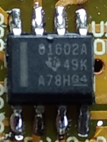

The situation is as follows: I have a considerable steady equipment production with these OPA1602, however, from the last lot of components that I have received, I clearly identified differences and test failures with this new lot order. I need to confirm if there are significantl production differences from the chips that I show in the images.
With the chip from image A, the equipment works properly, however, with the chip from image B, it DOES NOT.

IMAGE A
IMAGE B

    There should not be any significant production differences between the two lots. It is possible that if the original design was marginally stable, that small variations lot-to-lot could be causing the issue. If you'd like, we can take a look at your design to see if there are any trouble spots that could be responsible for this.

    first of all, thanks for your reply. The situation is as stated originally: I replaced the new "wrong" versions of OPA to the oldest ones that I still have, and the issue is gone.
    My team and I are clearly sure that the issue is due to this new lot. However, we cannot see why coult it be.
    Unfortunately for us, we have a big amount of chips with the same description, and for consequence the same lot...

    What exactly is the issue you are seeing with the newer lots? What symptoms does the system exhibit?
