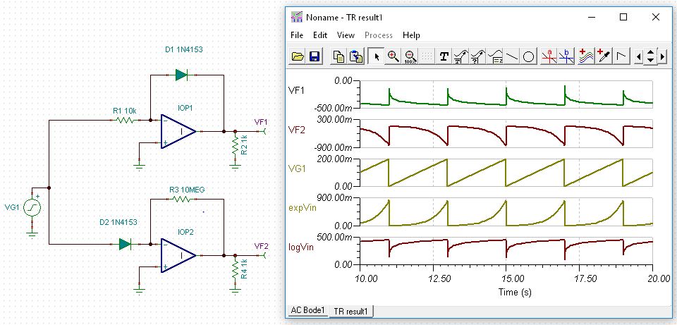

Hello every one,
Please, Explain for me. "Why use log opamp and anti log opamp" in document. Thanks

    Can you describe in detail in what application you are planning to use either a log or anti log amplifier?
    Sean
  • Hi Sean,
     My describe in file pdf.2055.prutchi_mca.pdf
  • Hi Lai,
    A log amp is exactly what it sounds like. Its output voltage = -Vt*ln(Vin/(R*Is)) plus an offset, where Vt=26mV and Is depends on the diode. An anti-log amp instead exponentially increases its input voltage, with Vout= -Is*R*e^(Vin/Vt). In this application, a log amp is used to make the exponential difference between reading events and reading nothing more manageable, similar to how using the dB scale makes analyzing amplifiers more manageable. Here is an example of both amplifier circuits. Note that they are inverted.
