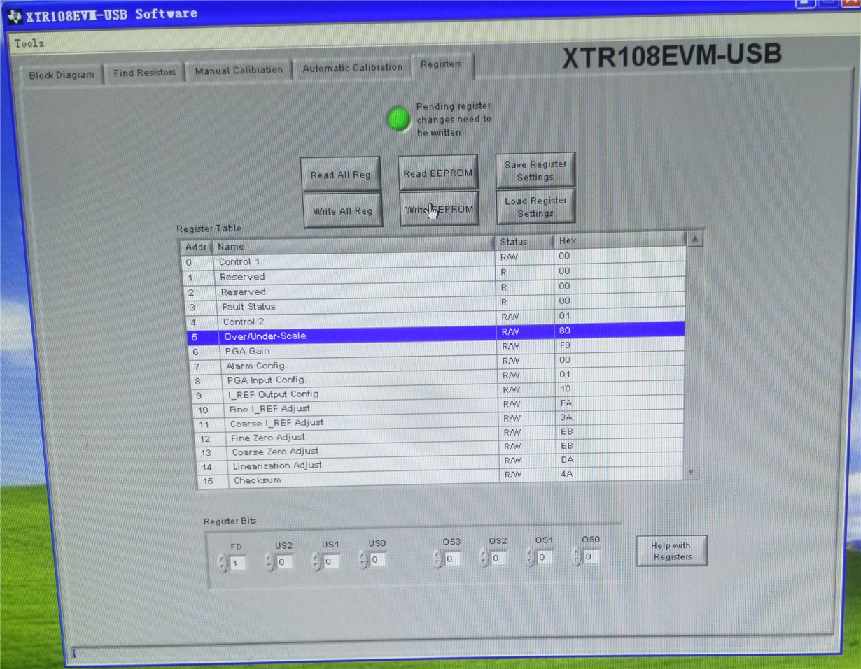

  • Hi user5222239,
    The version of the XTR108EVM users's guide available from the product page should be the most recent. Looking at the design files, I see no differences between the sensor board schematic in the user's guide and the latest version we have locally. The EVM does have the option of disconnecting that charge pump in order to user the XTR108 in current-output mode.
    Regarding debugging the output issue, it's very important to know the register/EEPROM values, since they control routing of the excitation current, PGA inputs, and excitation routing. Without knowing this information, it's going to be very difficult to debug this issue.
  • Thanks for your quick reply!AND I debugged the "XTR108 EVM Board" and my own circuit again. my goal is use voltage mode with 0V~2.5V output,And I still have some problems with XTR108.
    1.    For "XTR108 EVM Board":   the register is shown in fig1.The current of pin1(VI-0) and pin2(VI-1) is existence, but the ouput voltage is 0V, and the output voltage don't change with the input  resistant(PT1000).   Why?  BUT  last week I debugged the "XTR108 EVM Board" according to the user guide,the output voltage is right.    Please help me with the question, thank you!

    2   For my own circuit, the register is shown in fig2. I have changed the I_REF Output config from ff to 01, After I changed the register the current of pin1(VI-0) and pin2(VI-1) is existence ,BUT the output voltage is still 0V.why? Please help me with the question,thank you!

                                                                                                                         fig1  the  register of "XTR108 EVM Board"
                                                                                                                          fig2      the register of my own circuit

  • sorry I use the wrong word.  What  I mean  is  the registers of the XTR108 always change, as shown in fig1.
    After welding circuit board and give the circuit power the registers data is shown in  fig1. And I debug the circuit according to the Handbook“XTR108EVM-USB Evalua board and software tutorial”,the registers data can not turn to correct value as shown in fig2.  So  I change the registers  to the correct value as shown in fig2 with the Debug software,but when I clik the “calculate initial settings”button or the “read all registers”button,the registers turn into random data like fig1. I cannot debug the XTR108.  After that I tried several times to change the registers,the situation is same as before.
    Can  you  help me with the problem ,thanks very much!
