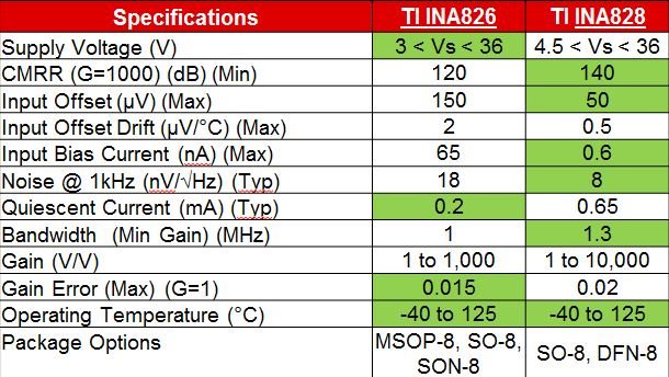

  • Hi Mike,
    Here is a spec comparison of the INA826 and INA828:
    You can see the INA828 outperforms the INA826 in most regards.
    I am not an expert in EMG amplifiers so I am not exactly sure how the signals compare to an ECG, but I believe the principles are very similar and you are still dealing with fairly low frequency signals, and consequently you would likely be more concerned about the low frequency CMRR. The ECG presentation demonstrates how even very small tolerance variations in ac coupling capacitors can heavily degrade your low frequency CMRR due to an imbalance in RC time constants. This is why the servo method with an integrator feeding back to the reference pin is used, as it avoids the need for ac coupling capacitors. However it has to correct for the gained up dc offset and if there is not sufficient headroom for it to do so it will not produce the intended ac coupling effect.
    Adding gain limits the usefulness of the servo method mentioned above. It is true that CMRR improves with gain, but keep in mind you will also be gaining up the noise of the device along with any externally coupled noise and any offset errors. Generally speaking it is best to place your gain in the front end to avoid gaining up the noise and offsets of downstream components, but sometimes it works better to limit your bandwidth before applying gain.
