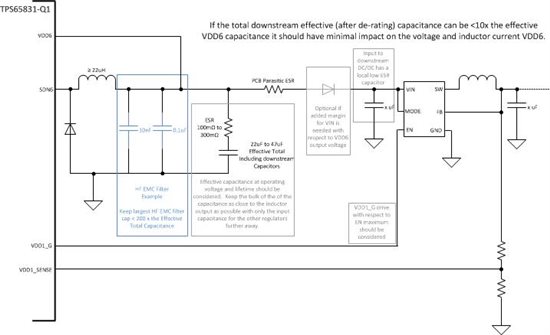

  • Using these assumptions we could approach this using the TPS65381 as the main PMIC and then use a TPS57112 as a downstream DCDC converter for the TMS570 instead of the VDD1 LDO controller.   http://www.ti.com/product/tps57112-q1?keyMatch=tps57112&tisearch=Search-EN
    The TPS57112 is a 2A capable output DCDC converter.  If the input is supplied by the VDD6 pre-regulator of the TPS65381 we can make a few assumptions about input voltage to output voltage and get the load current impact worst case on the VDD6 regulator.  I have added the option for a series diode to drop the votlage further from VDD6 output to add margin for the absolute max range of TPS57112 (7V abs max, vs 6.6V max output of TPS65381).  The table below maps some assumptions on these rails to get to a worst case load on VDD6 of about 404mA if it operates all the way down to minimum Vbatt input of 4.2V.
    TPS57112 with series diode for VIN margin

    We could make the following assumptions on the application voltage rails and current splits:
    Voltage Regulator VDD6 Load Current (max) Current Margin
    5V VDD5 200 150 mA
    3.3V VDD3 300 50
    VTRACK 100 0
    1.2V TPS57112 403.3613 N/A
    All Loads VDD6  1003.361 296.6387
     Please confirm if splitting the rails up this way would work for you and I can take the first shot of drawing up a basic schematic, it would be similiar to the one provided a while ago when this started.  I am also ordering some TPS57112 EVMs to try this by bridging the EVMS together in the lab.

  • Hi Gerald and Hideaki,
    Below is a schematic viewpoint of the DC/DC connections between TPS65381 and TPS57112.  If the power good levels in TPS57112 are adequet for your system you could use the power good monitor of TPS57112 which is open drain and connect it into NRES of the system. I have shown an alternative using the VDD1SENSE of TPS65381 as an alternative.  If you can use the TPS57112 power good it would free up VDD1 and that could also be used instead for the 3.3V rail or some of the 3.3V rail requirements.
    - Scott

  • Scott,
    That seems like a lot of board board area, but if that is our only option for now we will consider it.
