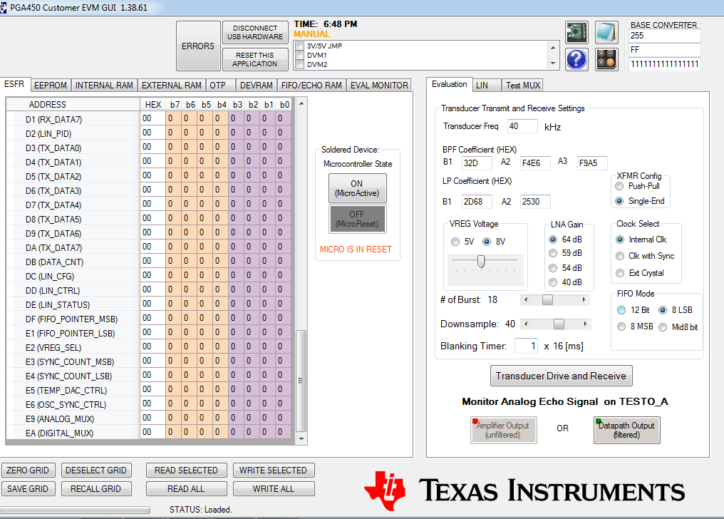

    Your jumper settings are correct; however, note that the OTP programming voltage should not be applied for an extended period of time. Can you post a plot of the FIFO data for both the short and long distance runs? Your issue may be related to noise or transformer tuning; we'll need to analyze the data first. Also, can you provide a screen capture of your Evaluation tab to display the Transducer Transmit and Receive Settings?

  • Vinoth,
    Can you send us the oscilloscope screen captures of the transformer output and DACO (TESTO_A) output?
    A single-ended transformer exposes the transducer to a DC equivalent voltage, and is not balanced like a push-pull transformer's negative-to-positive swinging voltage. As a result, the decay time may be longer for the single-ended transformer. The long distance waveform results you've shared indicate that the FIFO is storing saturated data. You'll need to configure the registers to store data after the initial decay period. If you used the default Blanking Timer of '0' on the Eval Tab, this may explain the extreme values of the data you're collecting. Here are my suggestions:
    • For the long distance measurement, try setting the Blanking Timer to the maximum value of 0xFF(or 255 in decimal).
    • For the short distance measurement, try setting the Blanking Timer to the longer value of 0x27 (or 39 in decimal). If this has no impact, increment the value until you do observe a difference (if any). Does lowering the LNA Gain factor for the short distance measurement make any difference?
    • Ensure the Enable Control (EN_CTRL) Register's BIT 3 ECHO_EN = 1 (Enable echo processing – the FIFO starts filling after the blanking timer expires).
