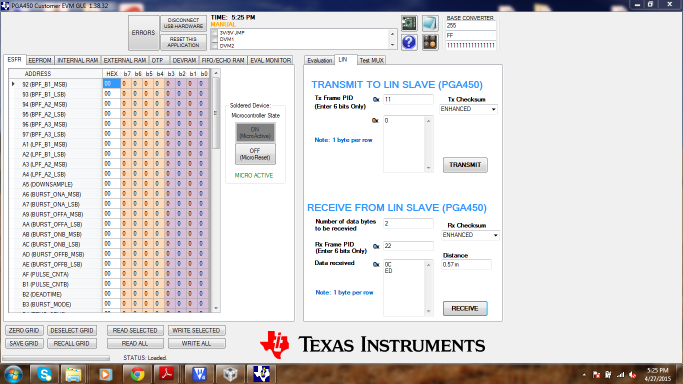

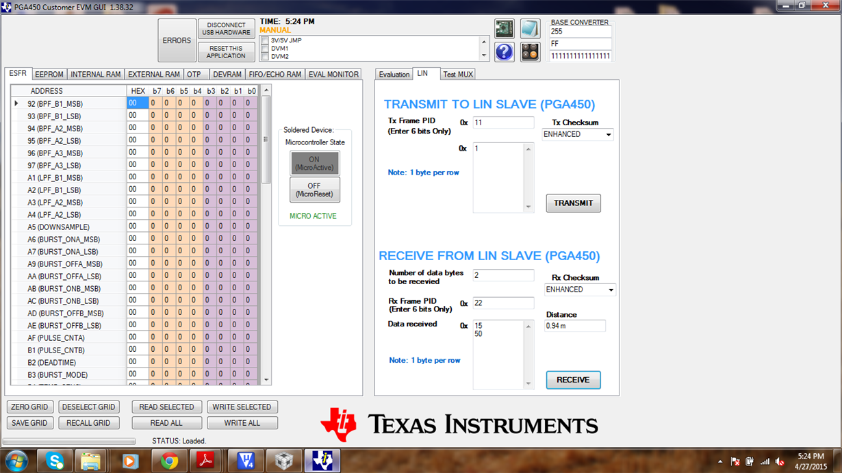

Hello Akeem,
We are testing PGA450-Q1 EVM through LIN communication using the GUI.
But for both short distance and Long distance we are getting constant values even though we vary the object distance.
Value for Long Distance - Data received 0x1550,Distance=0.94 m
Value for Short Distance -Data received 0x0CEE,Distance =0.57m.
Is there any particular settings in EVM.
i have included the images of both Short and Long distance settings in GUI for LIN communication.
Thank you,
Sanath Rai
Sanath,
There are two methods you can use to correct this problem:
1. You can observe whether the no-object / empty setup FIFO reading exceeds the EEPROM stored thresholds at the long and short distances constant readings of 0.94m and 0.57m respectively. You can try increasing the EEPROM threshold levels to optimize the trigger for your setup. This process is depicted on page 4 of the demonstration write-up you are referencing.

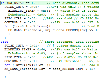

2. When using the LIN tab of the GUI, the drive settings transmitted to the LIN slave are called from the “PGA450_isrs.c” firmware file. These values are fixed, thus the firmware must be modified, and a new .HEX file must be generated/loaded into the PGA450-Q1 if you are attempting to adjust the FIFO waveform, while keeping the original EEPROM thresholds.
For the following example, I have placed a box approximately 82 inches from the transducer, and use method #2 to correct the constant LIN received distance problem.
Here is how I modified the snippet of code needing changes (also showing EEPROM threshold settings):
I was able to optimize the firmware settings after adjusting the values on the “Evaluation” tab via SPI to achieve a reasonable reading. Figure 1 shows the SPI based Evaluation tab’s graph optimized for measuring the box 82 inches away before I modified the firmware. After SPI optimization and modifying/reloading the firmware for LIN, Figure 2 shows the near equivalent FIFO graph as “Invoked through LIN”. When this Invoke through LIN” checkbox is checked, the evaluation tab will send the TX command entered on the LIN tab, then put the micro in reset to read and plot the FIFO data. This is basically a quicker way to test the PGA450’s firmware, instead of having to manually put the chip in reset and export the data to excel from the FIFO tab. Since the box is placed more than 1.5 meters away from the transducer, a long distance burst is required. Figure 3 shows the result of a long distance burst in the LIN tab when using the modified firmware (correct result).
