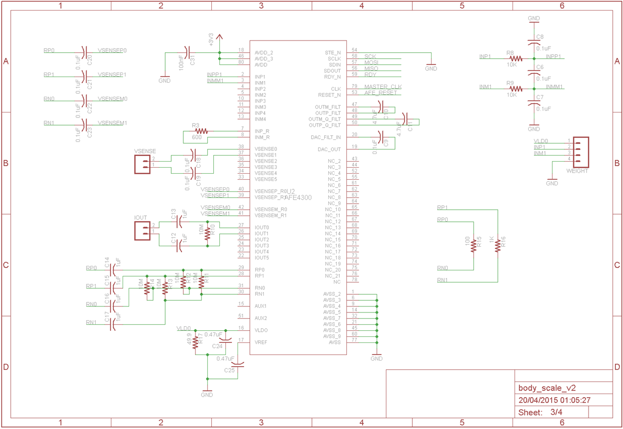

I'm quite a newbie, and trying to configure my AFE4300 into a BCM setting.
I don't need the weight measurement at all, and use only one set of the tetra-pole electrodes.
My problem is that 3.3V AVDD got increased to about 4.5V after connection. I must have gotten some connections wrong or missed some.
Can I leave unused pins for electrodes floated (Pins 22-25, 28-31, 33-36, 39-40)? Or should I keep them grounded?
How about pins related to instrumentation amps and IQ demodulators (Pins 2-5, 10-13, 47-50)? I left them NC as I am not using them either. Should I make them grounded even if I am not using them?
JY
  • I would not leave the pins floating because there could be some impedance on the lines. I would ground it if they're not used. This should be a quick test. Let me know if this does not solve your issue.
  • It turned out that it is because I used an arduino that runs in 5V, not 3.3V. This seems to flow 5V into SPI pins and somehow caused increase in voltage from 3.3V to 4.5V. With the change of the arduino to a different model with 3.3V operating voltage, I got it solved.

  • Hello Jinyong,
    What are your AFE register settings?
    Please refer to the datasheet for the register bits that need to be set after reset.
    Do you have an AFE4300EVM? Have you verified if your electrode setup works with the AFE4300 EVM and the GUI?

  • Hi Guys,
    I managed to successfully interfaced, AFE4300 EVM to arduino by removing the Mbb3 board, and my code worked fine. Then i translated all that to a pcb, with Atmel chip and AFE4300, but for some reason i cannot communicate with AFE4300 chip..
    for reference i am attaching my schematic with this email.
