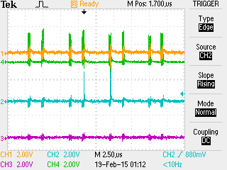

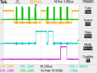

  • Hi Amy,
    Here's the SPI connections that I've probed on the AFE4403EVM board
    Yellow = Enable
    Green = Clock
    Blue = MOSI
    Purple = MISO
    I believe MOSI says 0x0 0x0 0x0 0x1 0x1 0x0 0x0 0x0 ( write register 000 (control register) 1 (read spi bit of control register) 1 (register number) then clock out response
    I think the particular SPI implementation leaves the final bit whatever way it was to get the behaviour between clocks
    Here's my implementation from a different MCU
    I've held enable low and written out 0x0 0x0 0x0 0x1 0x1 0x0 0x0 0x0 I have never received anything on MISO. AFE_PDNZ and RESETZ are high. Is there anyway to force something out MISO?
