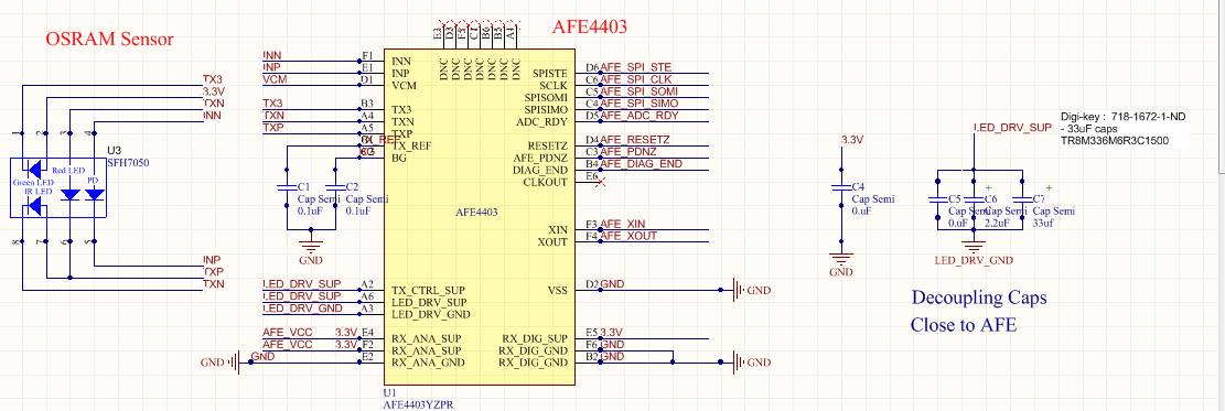

  • Hi Praveen Aroul,
    And the schematic I attached here
  • User,
    The Vfb for the green LED is about 3V, so you will need a larger voltage than 3.3V to supply the LED. To do this, you need to replace the 3.3V you have on the green LED to be LED_DRV_SUP. See the parametric spec on page 6 of the datasheet.
  • Hi Amy Schnoor,
    I take the Vfb for the green LED directly connect to the power supply 3.3V and it is lighting very well.
    The problem now is that, I think the ADC is not working properly. The value converted by it doesn't very over the brightness's change.
    I think the problem is the ADC ref voltage, but I cannot find any information related to ADC reference voltage in datasheet.
    Thank you very much !
  • User,
    Could you switch to using the red LED by changing CONTROL 3 register to 0x00, but keep all other conditions the same as you sweep the currents? The means as you sweep the currents you'll only be changing the LSB of the LEDCNTRL register. Let us know if you still see an issue.

  • User,
    On page 8 in the spec table it shows the ADC full scale voltage as +/-1.2V. And on page 20 the functional block diagram shows it as well. If you measure the voltage on the BG pin (pin#7) it should be 1V.
