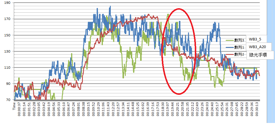

               Please see the below AFE4403 measurement results while motion status. Blue and Green line are different watch and red line are bracelet all used AFE4403. Vertical axis means calculated heart rate pulse (150 points/3sec). Customer point out waveform much varied from high heart pulse to low heart pulse and it is difficult to identify heart rate signal of user.
               Do we have any comments for below issue to improve this situation to customer to identify good signal from high *** to low pulse while motion? Thank you.
Parameters of AFE4403 as below:
ADC raw data range: 14000-16000
Rf: 50K
Cf: 250p
Gain: 6dB
