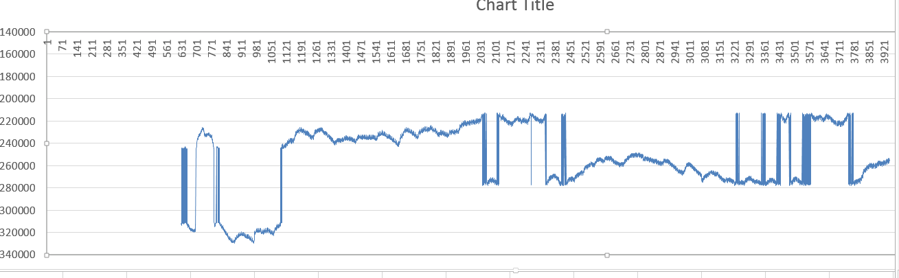

  • Thanks for reply, Amy
    These data was measured at rest. I tried many times with some different configurations but outputs seem to be the same.
    Data only continues in range of ~32000 (2^15), if data is below or above this band, they  will immediately  be raised up or cut down by ~66000
    You can look at below attached image
    Value in the vertical axis is read by AFE4400's ADC.

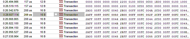

  • Two's complement data IS signed.  Bit 21 is the sign bit in 22 bit data.  Why is this thing giving negative numbers for light levels?  Negative light is not possible.
    SPI capture of config registers:
    Low power setting:
    Reg 22 power level = 0C0C
    2A = FFFC50 = 3FFC50 (22 bits) = bit 21 is 1 = negative number
    2B = FFFC2F = 3FFC2F (22 bits) = bit 21 is 1 = negative number
    2C = FFFC47 = 3FFC47 (22 bits) = bit 21 is 1 = negative number
    High power setting:

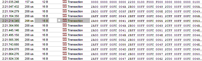

    Reg 22 power level = F0F0
    2A = FFFC41 = 3FFC41 (22 bits) = bit 21 is 1 = negative number
    2B = FFFC55 = 3FFC55 (22 bits) = bit 21 is 1 = negative number
    2C = FFFC53 = 3FFC53 (22 bits) = bit 21 is 1 = negative number
  • Scott,
    Section 8.4.1 (page 38) of the datasheet (assuming you are working with the AFE4400) describes the ADC output code for different input voltages.
    The output format of the ADC is 22-bit two's complement and the 2 MSB bits can be ignored.
    You may notice very small negative voltages during the ambient phases due to the channel offset of the AFE4400/AFE4490.
    The ADC full scale voltage can go from -1V to +1V. Since the photodiode (PD) current is one sided current, only one side (0 to 1V) of the ADC range is used. Now with no PD current during the ambient phases, we could be getting 0V ideally but with the channel offset this will be slightly higher or lower. This should not be an issue and is as expected.
    The channel offset will be cancelled out since the ADC value during the ambient phase is subtracted out from the ADC value during the LED phase (RED – RED Ambient or IR – IR Ambient).
