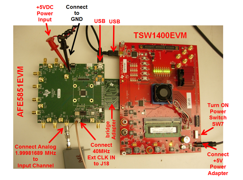

We want to implement our system with AFE5851EVM and TSW1400EVM.
And we try to follow the AFE5851EVM user guides.
But when we use the HSDC Pro to capture test data, it have "read DDR to File TIMED_OUT_ERROR Time Out error" error.
Some differences:
Hardware setup:
In the user guides, it has a bridge adapter between the AFE5851EVM and TSW1400EVM.
We have buy it, but haven't got it yet. So for now our hardware setup is like the second picture.
And the ADC power is 5VDC with 0.5 A.
Ext CLK IN is 40MHz and 13dBm(high 2.825V, low 0V)
My Questions :  1. Is bridge adapter necessary or it just to connect?
                            2. Does the hardware setup have any problem?

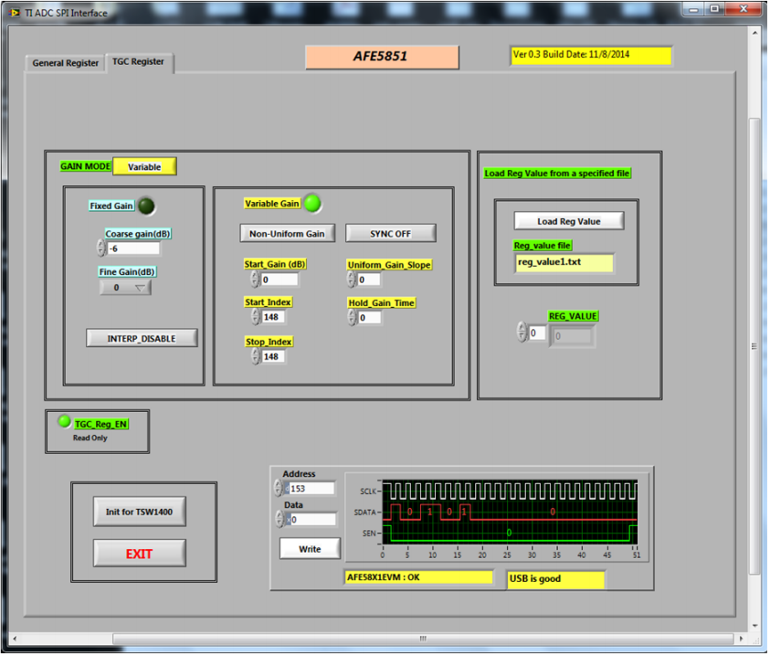

Software setup :
In the user guides, ADC5851 need to
init for TSW1400  ->  Select TAB "TGC Register" ->  press "Variable" toggle button ->  enter 30 in the "Coarse Gain(dB)" field, then press "Write" button.
But the AFE5851EVM software in the TI web is like below picture. It does have "init for TSW1400", it just have"init for TSW1250".
So the Software setup is like
init for TSW1250  ->  Select TAB "TGC Register" ->  press "Variable" toggle button ->  enter 30 in the "Coarse Gain(dB)" field, then press "Write" button.
My Questions :
1. Is the AFE5851 software version is right or not?
2. Is that we don't let the ADC to init for TSW1400 so that it have time out error?

    1. The adapter is absolutely required and should have shipped with the AFE5851EVM.  This is a known error, but I am surprised it is not fixed.  Could please tell me roughly when the EVM was ordered? 2015?  We will work on this error and meanwhile we will work to get you an adapter card.  Can you please write an email to us with the best address for shipment.
    2.  This is the most up to date software, with a few non-idealities.  For instance, "init for TSW1250" should now say "Init for TSW1400", but the current version works.
    3. The rest of your set-up looks ok.
    4. Please don't expect a data capture without the adapter card, it is impossible.  For future reference, the "read DDR.." error means that the TSW1400 is not receiving the data correctly, particular the FCLK or LCLK.  When D5 on the TSW 1400 is unlit,  there is an issue with the clock or connection and capture will be unsuccessful.

    How are you? For your questions of using AFE5851EVM and TSW1400EVM:
    1. Yes, the bridge adapter is necessary.
    2. It is connected between AFE5851EVM and TSW1400EVM and help signals such as data and clocks
    from AFE5851 to TSW1400 FPGA.
    3. the software version still can work with TSW1400 as well.
    4. Please notice: according to the data sheet, the following two registers always are '0'.
    Please keep "Invert LVDS output" selection always to be '0's (not used)
    Please keep "MSB FIRST" selection always to be '0' (not used)
    After you click any selection, then please click "Write" button.
    Thank you!

  • Hello Chuck,
    Thanks for your explanation. It is very detailed and helpful to me.
    I find that we order two AFE5851EVM in this year. (actually in one or two month)
    One have the adapter in the box, but the other doesn't have.
    I need more time to check that what is the correct date when we ordered the boards
    and that we buy one by one or buy two in one order.
    Because I use the board which doesn't have the adapter in the box.
    (I found that the other box have the adapter just in this morning)
    And the user guides doesn't mention the adapter frequently, so i mistakenly thought it might be ok to just combine the AFE and TSW.
    But now i know that adapter is absolutely required.
    For now I have one adapter(but two boards), and try with the above setting.
    And after test the capture in HSDC Pro is good to work.
    Thanks for your help.

  • Jhin,
    The HSMC-ADC-Bridge is not the correct adapter and there is no link for the correct adapter.  If you need a second adapter card, please let us know.  Also,  can you confirm where you order the EVM from please?
    Chuck

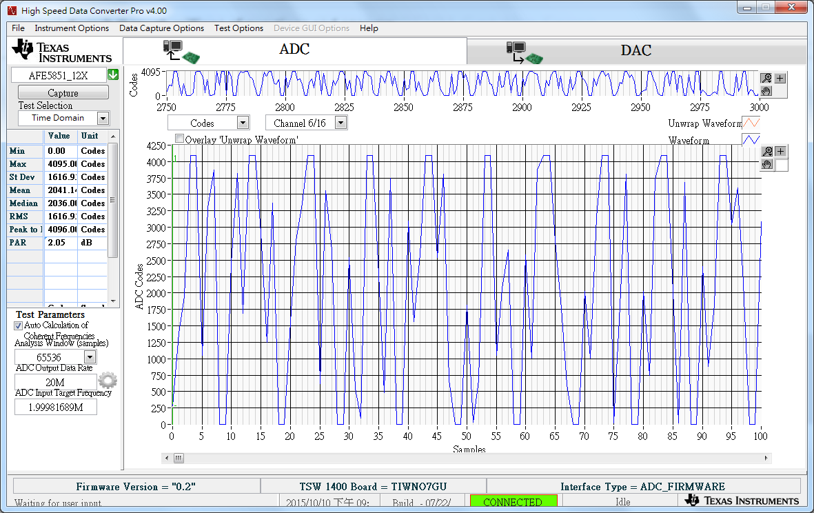

    And I get some problems in capture.
    After I connect the adapter between the AFE & TSW, and follow the user guides.
    I got the waveform like this.
    Input signal (0V~70mV, 1.99981MHz)  & the ADC 5851 software fixed gain 30dB
    CLK (40MHz and 13dBm(high 2.825V, low 0V)
    The 70mV signal in oscilloscope have not much noise like above picture.
    Then I try higher voltage input signal.
    Input signal (0V~1V, 1.99981MHz)  & the ADC 5851 software fixed gain 0dB

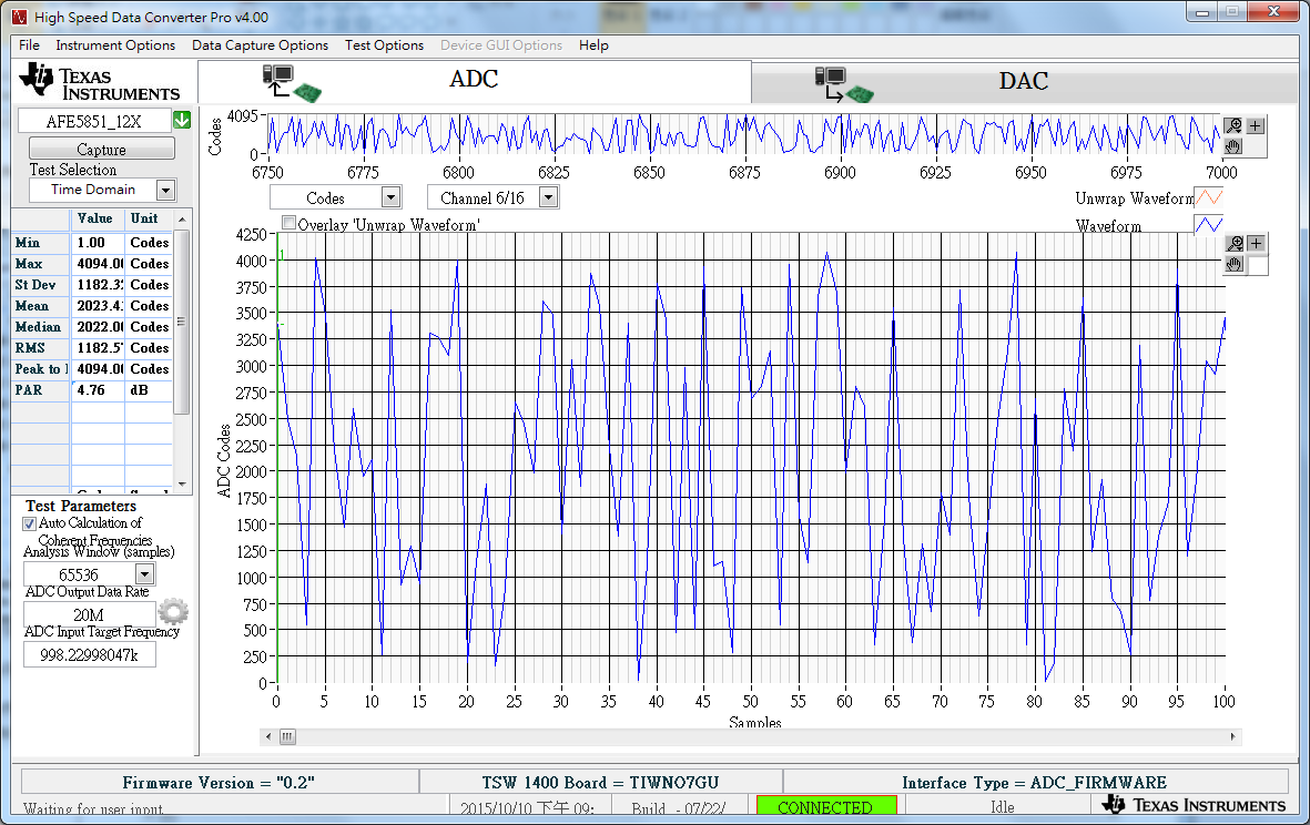

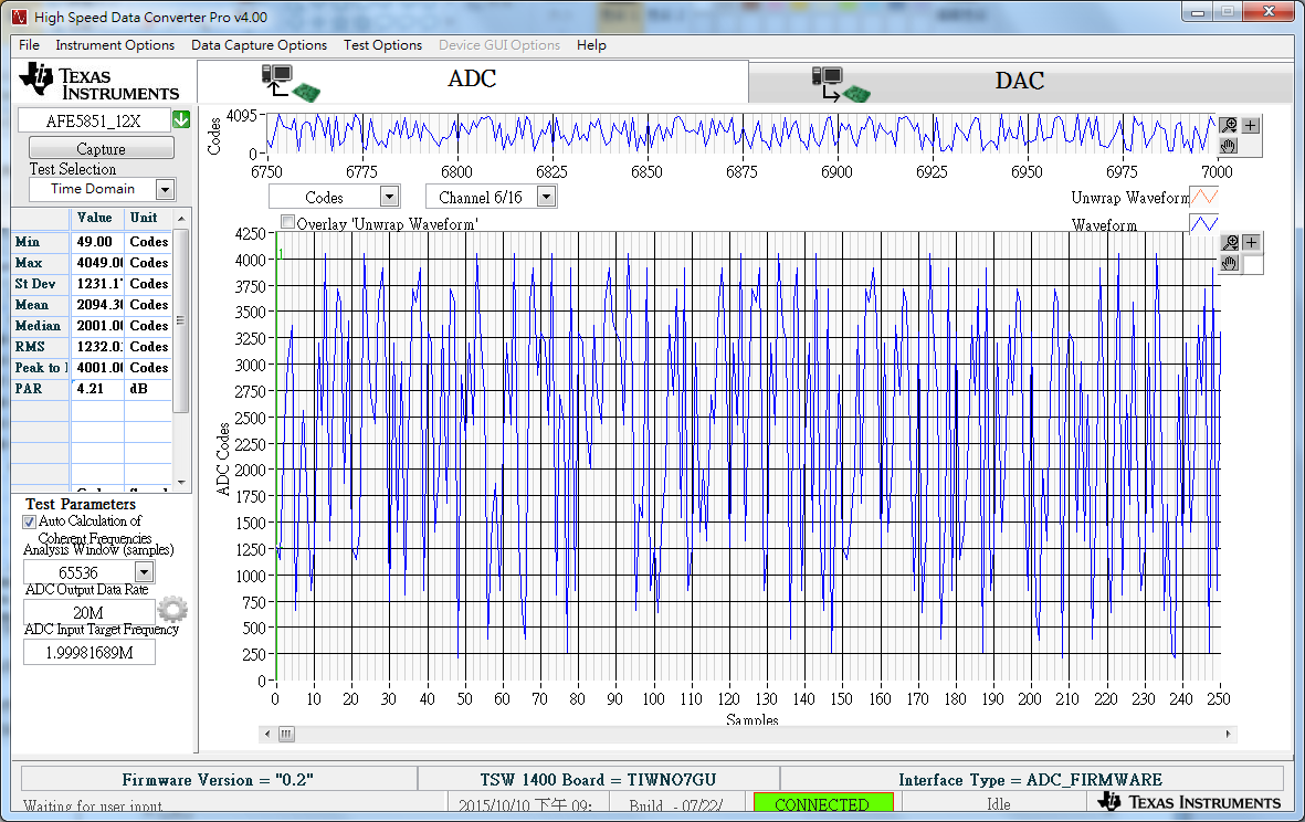

    And change the frequency of input signal.
    Input signal (0V~900mV, 998.229kHz)  & the ADC 5851 software fixed gain 0dB
    Input signal (0V~900mV, 100.013kHz)  & the ADC 5851 software fixed gain 0dB
    What is the reason to let the difference between oscilloscope waveform and HSDC Pro capture?
    Is that some setting I haven't done?
    Please help.

  • Hi Jhin,
    How are you? We tried to duplicate the same test setup as you did.
    Input signal (0V~70mV, 1.99981MHz) and we assume and set up 2 different register conditions
    as follows:
    1) Please notice: "MSB_FIRST" register is Not used anymore according to Data Sheet.
        but If in this case, "MSB_FIRST" is '1':
        You can see:
    2) Please make sure "MSB_FIRST" must be '0' (due to Not used):
        Please do the following step:
    Please try to run the same register conditions as mentioned above. You can see the correct data output from TSW1400 GUI.
