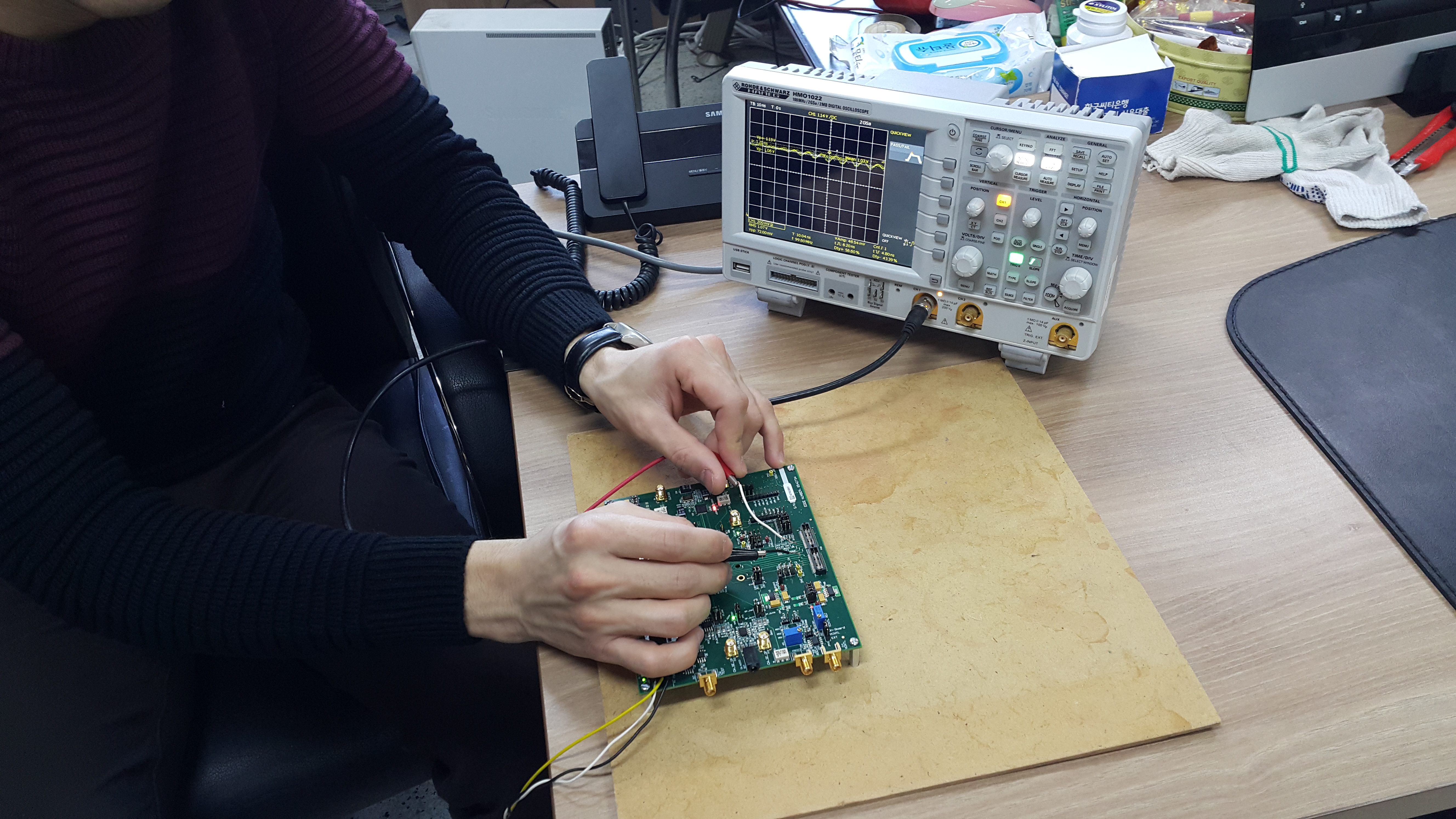

  • Dear Olu,
    The following photos show how I probe the P10-66 and P10-58 pins.
    I'm using alligator probe with a piece of cable. I connected the red cable of probe to P10-58 and the black one to ground (P10-60). Another time, I also tried red to P10-58 (DCLKP) and black to P10-56 (DCLKM). In addition, I probled FCLK by connecting Red cable to P10-66 (FCLKP) and black to P10-60 (ground).
    Note: Previously I mentioned that I saw FCLK only by changing the polarity. Because you said that was strange behavior from AFE5809EVM, I did the experiment again. I noticed that I can see the FCLK with and without changing the polarity(changing red with black cable) . The only difference was that the voltage becomes negative after changing the polarity.
    Here is another photo:
  • Hi Sajad,
    Are you using BNC-to-alligator cables there? Please use a naked voltage probe to avoid loading the clock source (probes generally have lower capacitance).
    Also, use one of the GNDx test points on the EVM for your negative connection. Now that you can confirm that you are seeing the proper FCLK (what amplitude?), you should be able to see DCLK also--the AFE produces both.
    Also, please try to mate the AFE5809EVM to the TSW1400 and follow the user guide's instructions on configuration and attempting a capture now that you have resolved the GUI problems.
    Sincerely,
    Olu
