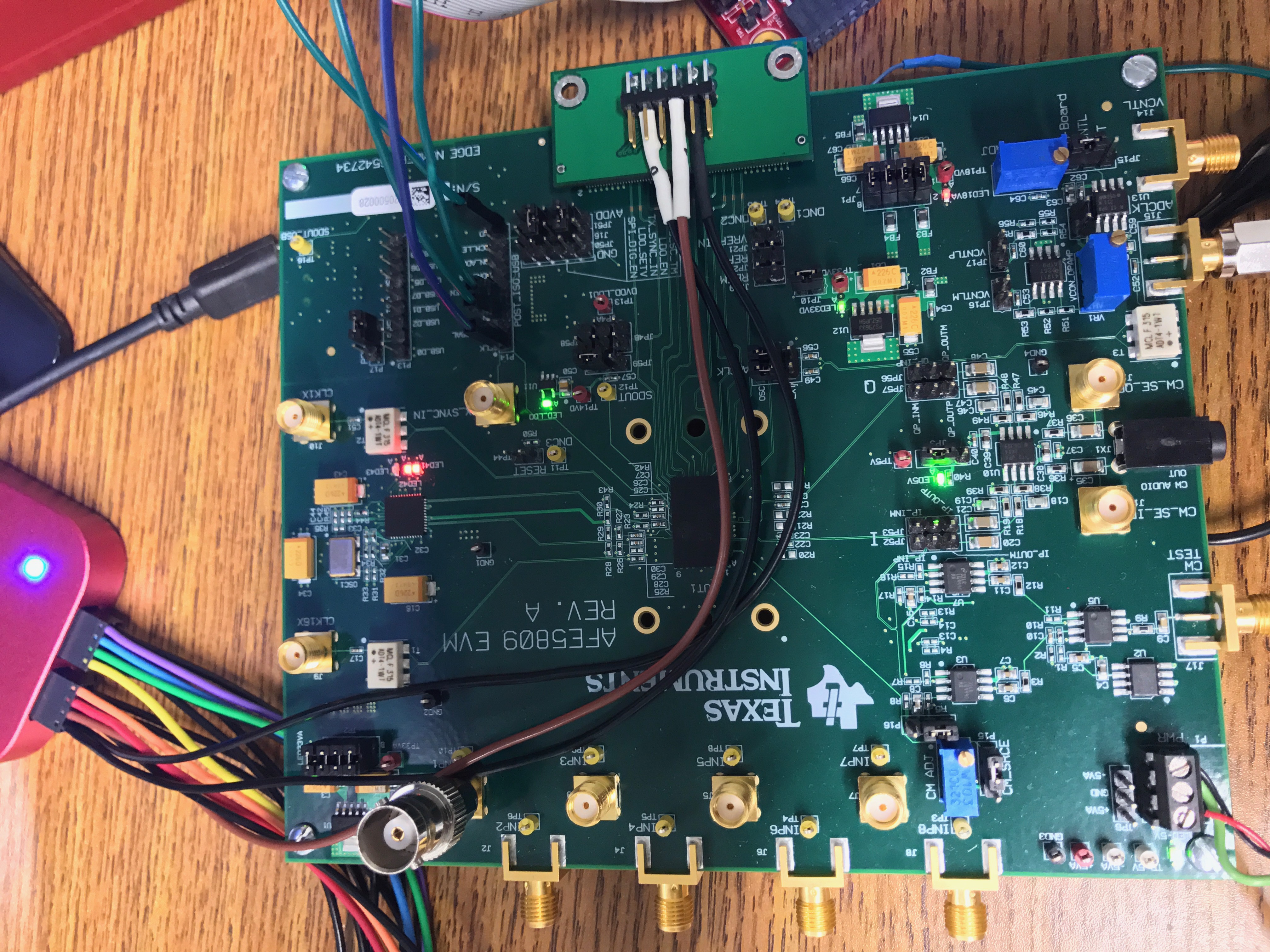

We're trying to configure SPI registers of AFE5809 using Zynq MicroZed, but unable to see any result.
As mentioned in page 52, register maps in AFE5809 datasheet. We have followed the procedure exactly but still, see no result on the TSW1400GUI side

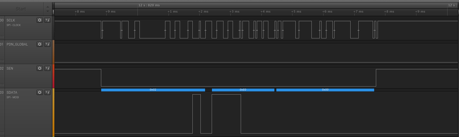

Here's the SPI waveforms seen on AFE5809 side, when configured through TSW1400GUI. And there is a ramp pattern see on the GUI die
24-bit SPI setting is to generate ramp test pattern. The data is verified through Logic Analyzer
#1
and, here is the SPI waveform, when configured through MicroZed, with the same register settings for ramp signal, but no result on TSW1400 GUI side
#2
For transfer, we are using standard 3.3V logic. The data matches, but there is no result. Is there something missing? Any help/suggestions would be really appreciated!
Further details:
Also, FB17 is removed, as suggested in this thread: https://e2e.ti.com/support/other_analog/imaging_afes/f/239/t/360353
The USB is disconnected and we are purely running the SPI from the on board pins.
SPI_DIG_EN is always high because demodulator registers are not being configured.
SCLK - 490 kHz
Data Width - 24 bits
Shift direction - MSB first
SCLK, SEN, SDATA, GND on P14 are exactly connected as it supposed to be.
Thanks!

  • Hi Vatsal,
    How are you initializing the device after removing FB17? Can you provide oscilloscope shots as opposed to logic analyzer captures?
    Also, can you please run your microcontroller logic at a slightly lower voltage--the max for the AFE5809 is 3.3V as shown below;
    SIncerely,
    Olu

  • Hi Vatsal,
    I am asking for actual analog signal captures from an oscilloscope.
    Also, can you please walk me through your current procedure for configuring through MicroZed after powering up the AFE5809EVM--are you initializing the EVM using the AFE5809EVM's GUI or the MicroZed board?
    Sincerely,
    Olu
    I want to eliminate AFE5809EVM's GUI. So I want to configure AFE5809EVM with Microzed. Anyhow, I removed FB17 so USB isolators are not powered up. So USB cable is isolated.
    I am connecting my SPI signal on the P14 jumper. Once I connect everything I run some register's settings. To test I am using inbuilt test pattern generator(Ramp signal) on AFE5809. Which can be accessed through 0x2 Register address.
    I am using disabling demodulator so I don's have to program profile RAM or profile coefficient.
    Vatsal
  • Hi Vatsal,
    The AFE5809EVM has an initialization routine at powerup/reset that includes setting the following registers to these values;
    Register 22 = 0x01
    Register 4 = 0x18.
    Subsequently, you can successfully observe the ramp signal after configuring register 2.
    Sincerely,
    Olu

  • Hi Olu,
    I tried why you said but It didn't work. I am using this setup,
    Can you please let me know your AFE current consumption when you disconnect FB17?
    When USB connected : 600mA
    When FB removed : 1.02A
    Is it the case with your setup?
    Thanks.

  • Hello Olu,
    Well, It is working now, I am able to configure AFE chip without GUI(FB17) disconnected.
    Current draw on start-up is still 1.02A but when I trasfer Register Values it comes down to 0.83A. It is different then the current draw you have but I can see the SPI working now.
    Thanks for the help! Really appreciate it!
    Vatsal

    The good news is that I have solved the issue with the SPI connection, thanks to your information in this thread. I have another issue that I hope you can help me solve.
    The following image is from your previous post. What is that connector that you are using to read the output of LVDS?
  • Hi Sajad,
    I am using that connector to observe LVDS signal.
