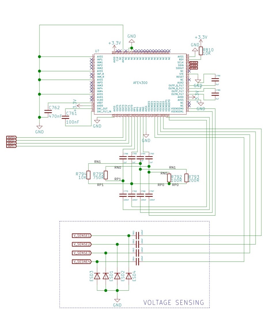

Can I use AFE4300 for bio impedance measurement ?
If there is any reference design ?

Hussain,
I am assigning your post to the correct applications engineer and you should receive a response soon. However, you should be able to use the AFE4300 for a bio impedance measurement and customers have used our AFE4300EVM as a reference design.

I see in reference design 10M resistors connected to IOUT pins and RN-RP pins, Should I add them or they aren't necessary?
