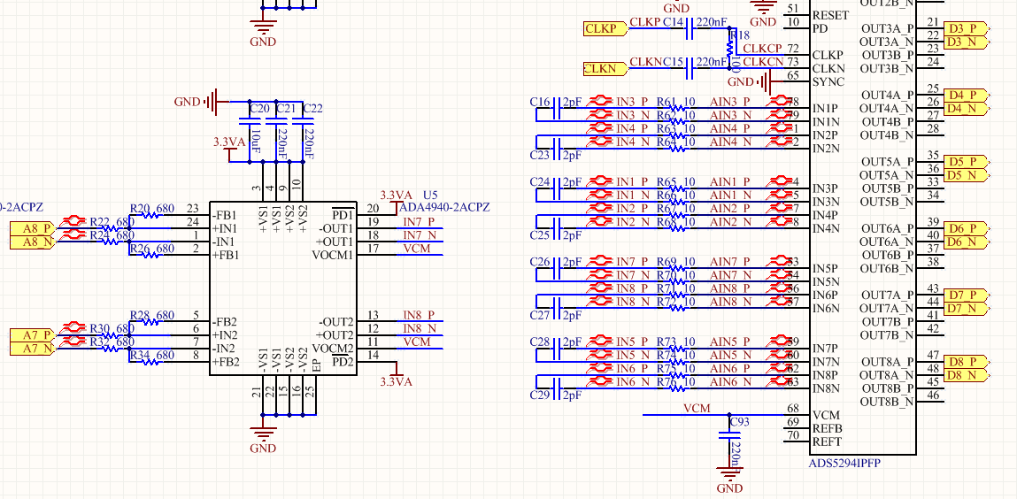

Schematic: ADC driver: ADA4940

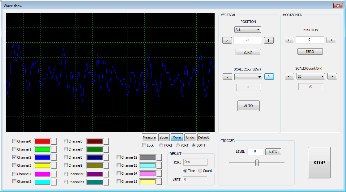

  3. The LVDS output of the ADC have been correctly de-serialized. The data is shown on the scope which is developed by myself(which is currently used in our product, its function is ok
    Test result:
    no filter,no decimation. Floor noise PK to PK  value is about 40(about 5 bit).
    Fs/8 low pass filter,no decimation. Floor noise PK to PK  value is about 20(about 4 bit).

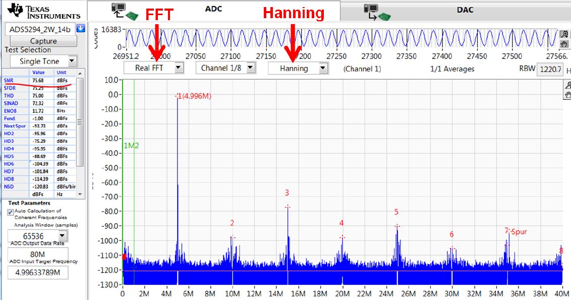

    As you can see from ADS5294 Datasheet, it shows
    our device noise performance is about 75.5dBFS (-1dBFS at fin=5MHz)
    When we are using ADS5294EVM board to measure the ADS5294 device performance,
    please refer to our ADS5294 users guide.
    You can see our test results show, one of test results show as:
    Here the device noise performance is about 75.68dBFS (-1dBFS at fin=5MHz)
    That is very consistent with our datasheet.
    Please also review our schematic from ADS5294 users guide.
    The low SNR result (due to the higher noise) issue may be caused by the input signal amplifier.
    Here is one example (in the users' guide) showing that you can create a filter (such as BP filter in this case)
    to reduce the noise coming from the input amplifier.
    Thank you very much!
    Chen
  • Hi, How are you?
    Here are the photos for ADS5294 three diagrams.
    Please take a look.
