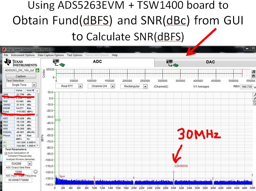

  • Hi Val,
    How are you?
    We were doing very similar test conditions (as you mentioned) in our bench here
    to test ADS5263 EVM by using TSW1400 board to capture the output data from ADS5263 device.
    1) Here are the settings including input signal freq=30MHz, input clock freq=100MHz and more:
    2) Then we used TSW1400 board to capture the output data from ADS5263 device and
    also use its GUI to calculate the fundamental (in dBFS) and SNR (in dBc)
    3) Then we could calculate noise floor again (by using the equation you sent to us)
    shown as below. As you can see we can get very close noise floor test result to
    the theoretical calculation.
    Please take a look:
    4) Also please double check the following 2 Jumpers are connected correctly.
    Thank you very much!

  • Hi Chen, could you please explain how can i finde out SNR (dBc) from GUI, i mean how i can obtain SNR (dBc) for ADC at all? I can't understand why SNR = -31.759 (dBc), because in the program window i see 15 dBc max.
    And one more thing, in formula of Noise floore calculation you get -141dBFS, why not -141 dBm, becaus FS in dBm.
    Val.
  • Hi Val,
    I think you are misunderstanding the noise floor formula. The first page of this app note talks about the difference between noise spectral density and total noise power integrated over the Nyquist bandwidth.
    The dB level of the "visual noise floor" you see above is dependent on the number of points used in HSDC pro's FFT but the total noise power remains the same as the sampling frequency(and hence Nyquist BW) remains the same. The SNR number is calculated using the total noise power minus some harmonics as stated in the datasheet, not the power level of a single frequency bin.
    The negative value of SNR in dBc is actually saying that the total noise power is higher than the carrier signal power level (which is very low at -119dBFS).
    Sincerely,
    Olu
  • Hi Val,
    How are you?
    Please take a look at the following page:
    First we receive the fundamental power (called it as Ps)
    The second we sum all the power from the noise floor (called it as Pn)
    Then we take the ratio of Ps/Pn.
    Please don't worry about + or - sign, because some people prefer to using the ratio of Pn/Ps.
    That is ok!
    Have a nice day!
    Chen
