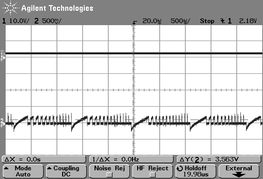

    Here is a scope shot of the sense resistor (bottom) and cpu reset (top) when the reset event hits
    And here is the sense resistor (0.33 ohms) during normal operation.

  • The scope shots did not come through.  Let's try it again.
    Scope shot of cpu reset (top) and current spike i a sense resistor.
    And one of normal operation
    Hopefully that one worked.

    Do you have a current probe to capture the current through motor A when the event occurs? The spike on the sense resistor is implying 12A. Hopefully these current spikes will help us narrow down the suspected area.

    We do have a current probe, but it is only rated for 100KHz, so I would not expect it to be of nay use catching a 20ns spike.
    I assume the wide ramps in the running scope shot  would be a step command, the blanking interval, and current ramp up to the first PWM cycle of a step.  I see no excess current there.
    I cannot correlate the spike with any particular point in a step cycle.  I would like to rule out the DRV8811 as a culprit, but he spike just before reset still needs to be explained.

    The other U10 sense resistor showed some current transient at reset time, but was not as severe as the side I scoped.

    Here is a shot, reset on CH1, a motor winding via a 100mv/A current probe on CH2.
    2234.20-MotorCurrent_at_reset.TIF

    When the event occurs, it looks like several pins are going negative. ISENA is going to -4V, and RESET is going to -3V. Both of these excursions violated the absolute minimums of the device and can cause parasistic circuitry to activate.
    Our design team has requested that you capture the AOUT1 and AOUT2 pins along with the ISENSA (zoomed in as before).
