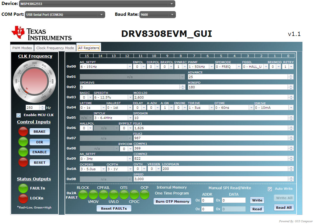

  • I'm using normal mode. In this mode I already tried to increase LOOPGAIN with fCLK = 250 Hz without any impacts. So I incremented MOD120 until fCLK = FGOUT was possible. See attachment for more information.
    gmlo
  • It's excellent you've gotten speed to lock.  At that point, you should be able to load down the motor with your hand and maintain the same RPM.  If RPM drops when doing that, then either:
    • LOOPGAIN should be increased,
    • The external power supply max current should be increased, or
    • VLIMITER is being reached on ISEN and a smaller sense resistor should be used.  The default on the EVM allows 5A.  If you're not using a current probe to see the actual peak current, keep in mind that if the power supply says the average current is 2A, there could easily be 5A peaks.
    All your GUI settings look good, but I would still prefer MOD120 = 3970 if that gives good results.  Its default of 2048 is needed for PWM modes to have a 1:1 duty cycle behavior.
    Once you have the closed-loop speed control working well, and with a good torque operating range, the next 2 things you may want to optimize are the startup profile, and the spinning flutter.  Registers LOOPGAIN, SPDGAIN, FILK, and COMK are the primary ones to tune.  As you go through that, use the "minimum total gain" methodology described in Step 4.
