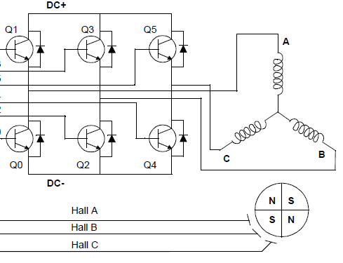

    2. I love to make things from raw materials so I want to use the 6 MOSFET configuration (as seen below ) to drive the motor . For commutation I am gonna use any suitable MSP430.

  • Hey Ryan,
    The motor driver is not a problem at all. I will develop that one using Some mosfet's and a microcontroller. I learnt that how to drive a bldc motor with hall sensor. BUT after I found another way of driving "BACK EMF METHOD" , which is cost effective one . I read about it but have some doubts.
    As I mentioned above my doubts are,
    1. The feedback which I am getting from hall sensor about the position of motor, is be the same for back emf              method.
    2. what would be the range of back- emf if we use maximum +12v (the voltage which I am using to drive the motor) for CD-ROM BLDC MOTOR.
    3. do we need to use ADC for measurement of the back emf or any compare-tors or we can usen simple I/O.
    4.  if I am right then we gonna measure the back emf between the non excited coil and GND.
    5. There is a minimum speed that must be attained for sufficient BEMF to be measured.
    Dharmendra Sharma
    INDIA
  • Hi Sharma
    Sensorless method is much more trick technology than Hall sensored BLDC control method. There is no detailed and standard implementation for this sensorless method. Merits and faults are always come together. And most good experiense of sensorless control are protected IP in different companies. If you want to learn, start from TI instaSPIN should be a good choice. And also you can "google" lots of related materials.
    Some comments to your questions:
    1. The signals feedback from Hall sensor and BEMF are totally different and need different dealing as well.
    2. BEMF is proportional to the motor's speed. So at startup or low speed, you will get not enough BEMF to do the commutation control. This is the most tricky point of sensorless control. To your question, normally the motor's BEMF range will below VM in the normal running speed range. You can understand this through the basic model of the DC motor. Please google the "DC motor model".
    3. Comparators are used very common. But if you need complex filter or integration of BEMF, ADC will be needed such as in TI InstaSPIN. GPIO may not be enough.
    4. Usually it is compared between the non excited phase node and the center tap. (It is easy to understand in star connection while could be artificial one in delta winding motor). If sampled by ADC, it is measured refer to GND.
    5. Yes. Before you can get enough BEMF, you don't know the rotor's position and just control in open loop or apply some observer.
    I think you will get so many questions during your development, it is recommend you choose one method first and get a deep diving. Also I have some doubt on your modified CD-ROM motor, it may not able to output enough power to lift your aircraft. There is too much different between a CD-ROM motor and a high power density aircraft motor. It is really critical to your success fly. Driver or driver method doesn't help a lot about this.
