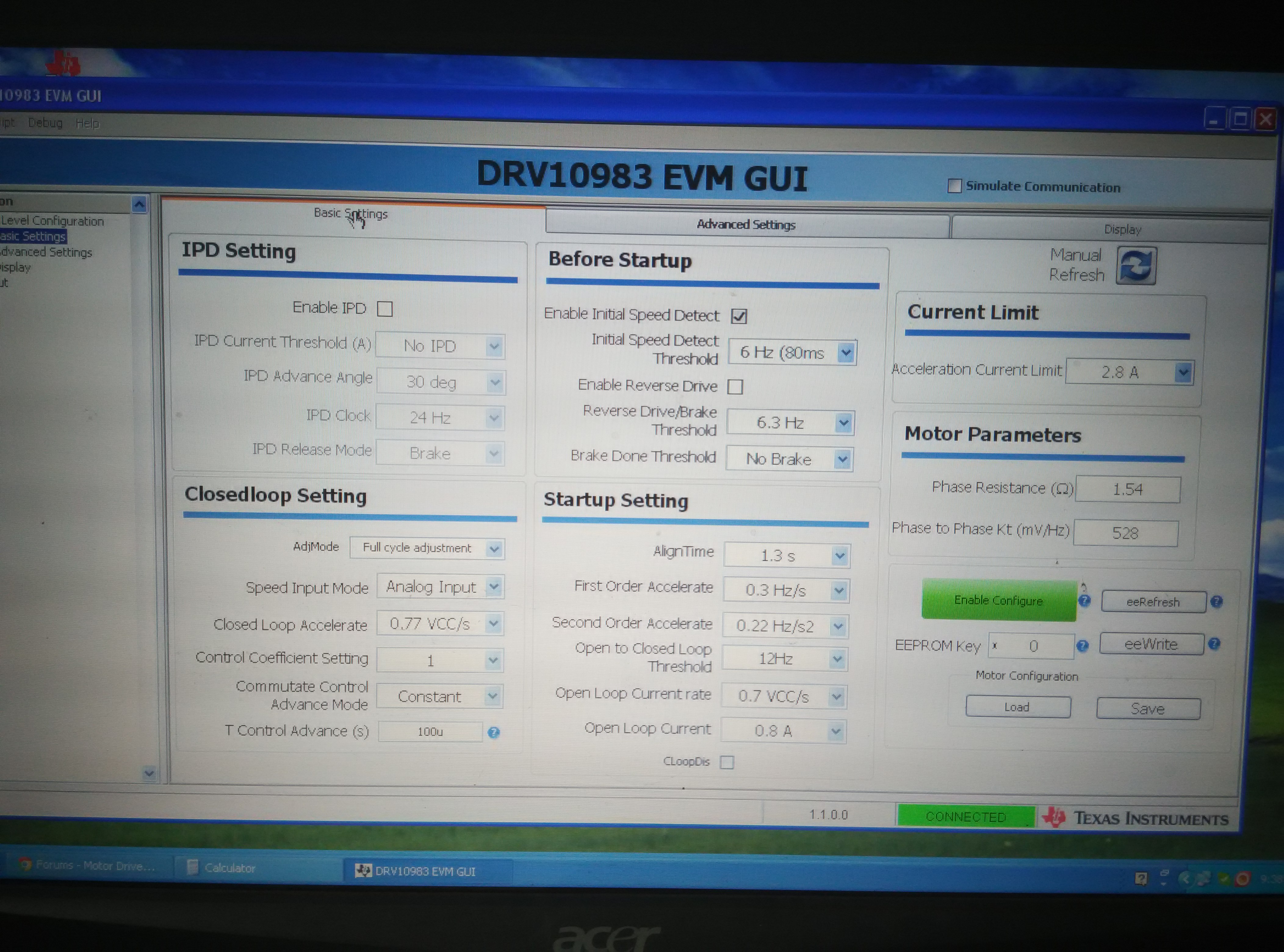

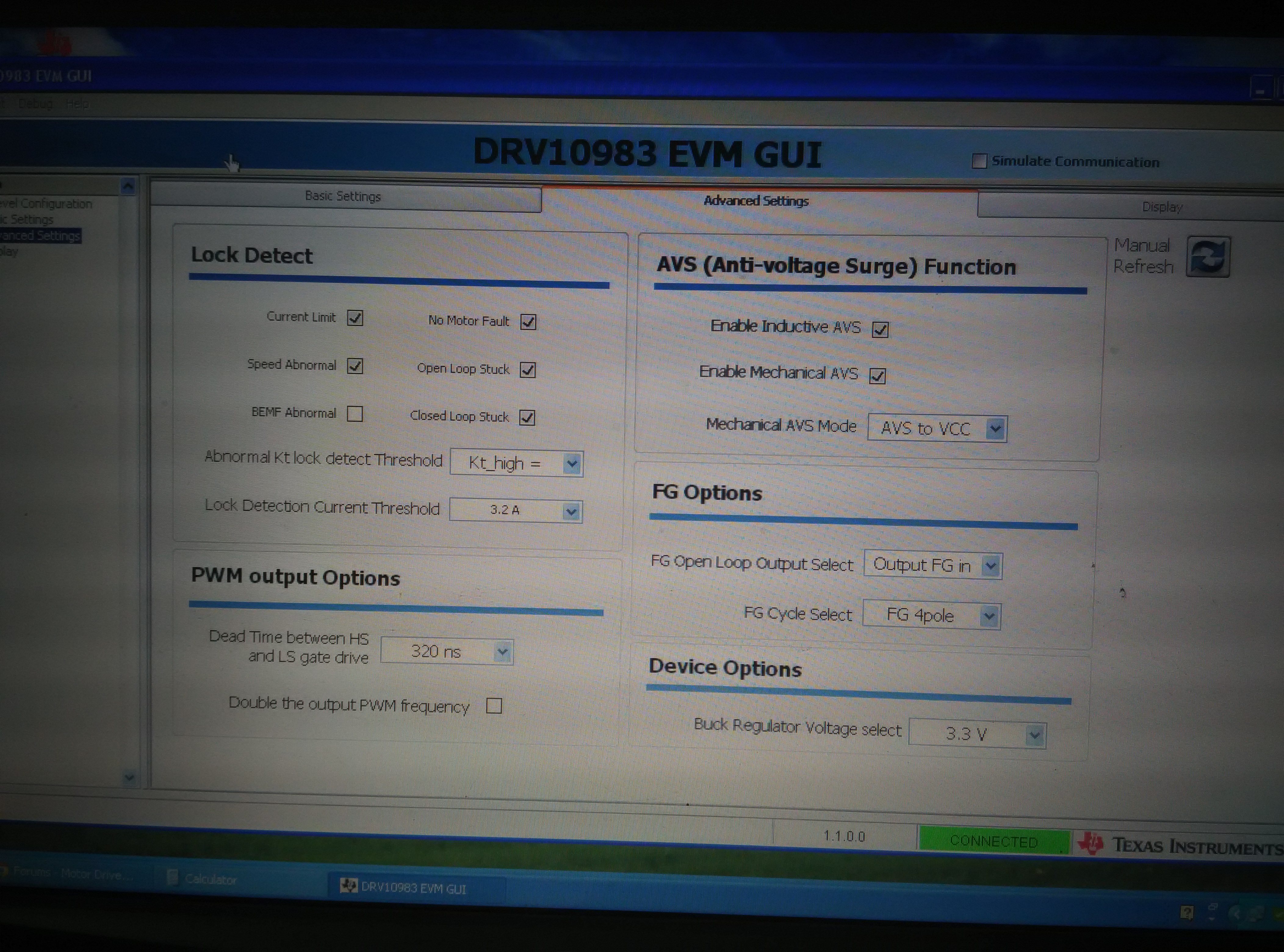

  • Shruthi,
    You have to properly configure, Before start-up setting on basic page and lock detection current thershold on advance setting page.
    Please share the GUI images of these two pages. Also, let me know following for your motor:

  • Hi Sir,
    Thank you  for the reply.
    please  find the attachments and data
    1.      1.5 Ohms
    2.       509mV/Hz
    3.        24V,340RPM
    4.        1.5A@340RPM
    5.        16poles
    with the above configuration motor is rotating however sudden changes in the speed it is not adapting to it(FULL SPEED to OFF and then ON it immediately),i tried disabling current limit lock, changing the lock detection current threshold and disabling acceleration  current limit but the problem persisting .

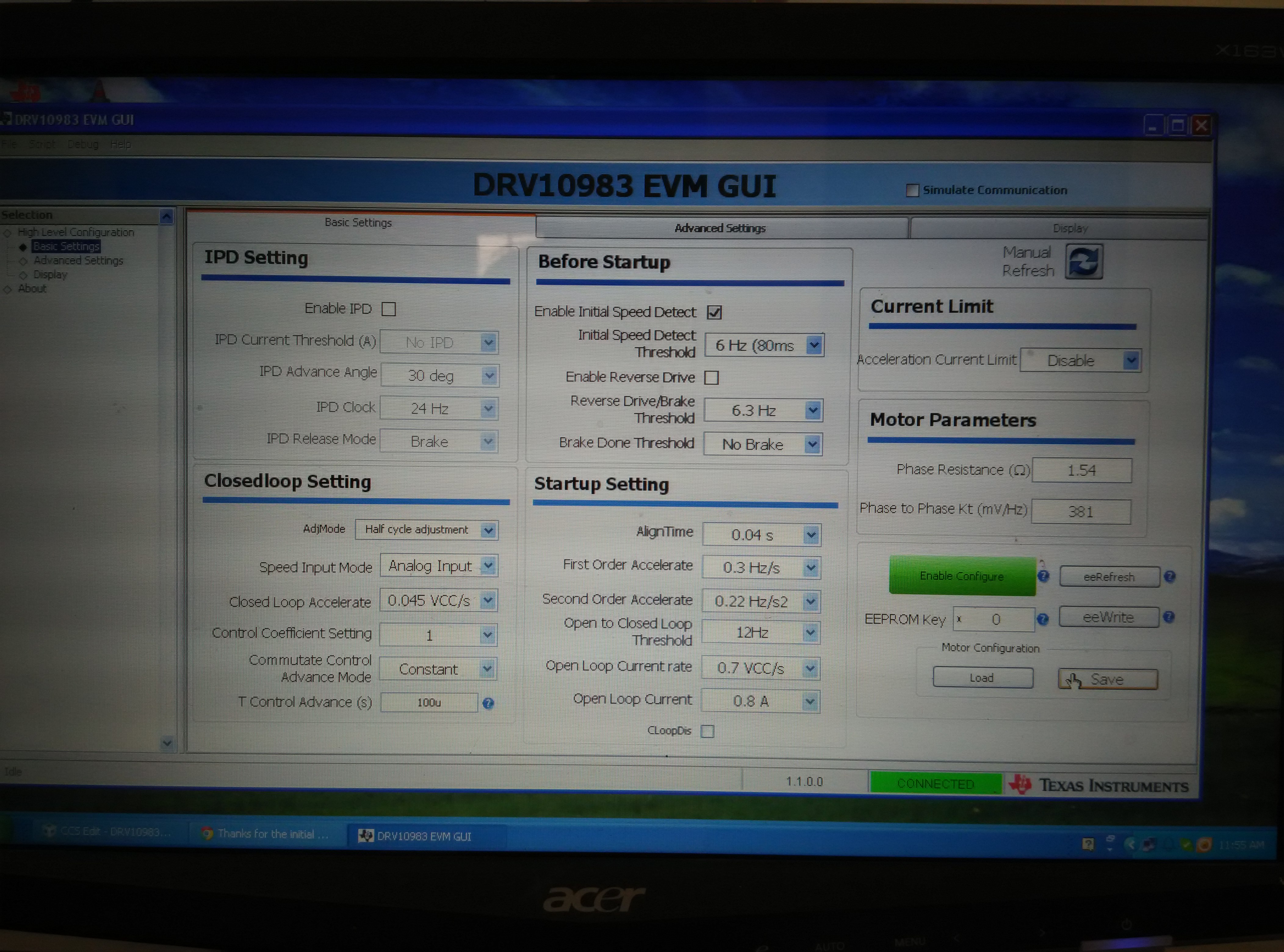

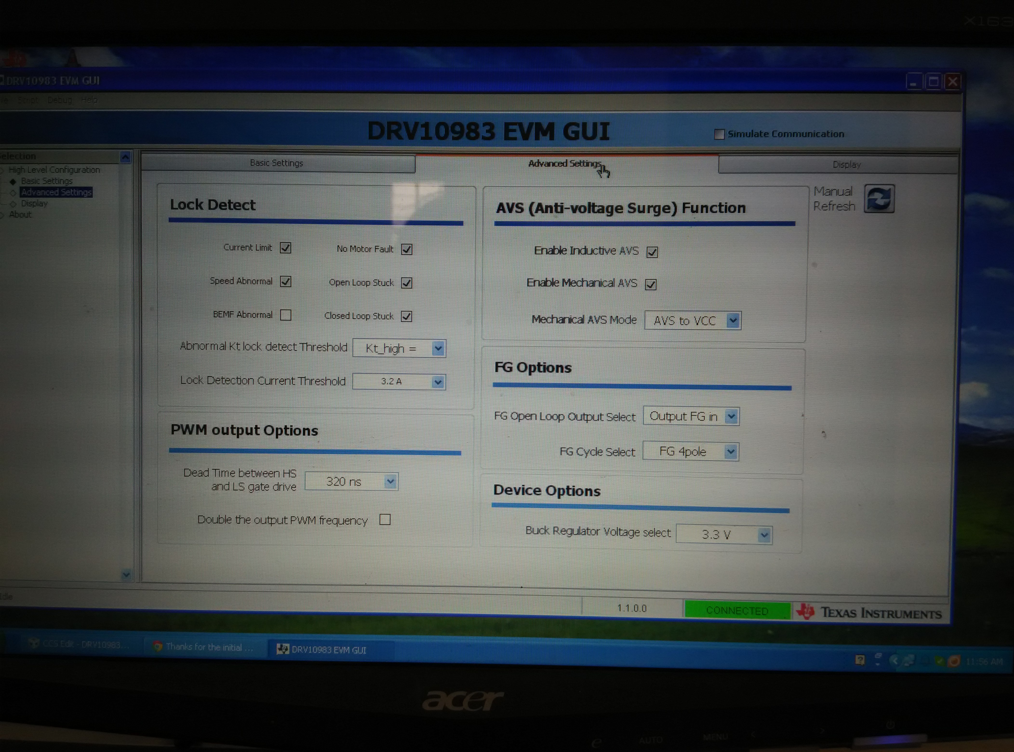

  • 1.disabled acceleration current  limit and kept lock-detection threshold to maximum 3.2Amp
    2.before i have setted  Initial speed detect threshold to 6Hz and enable Initial speed detect but still at lower rpm if i on the motor it was getting locked.
    3. de-selected all lock detection faults
    but no change :-(
    more over my current sensing resistor has blown away ,i think because of disabling all locks apart from that no damage  to the EVM !
    Today i checked enabling IPD settings there is not much difference!!

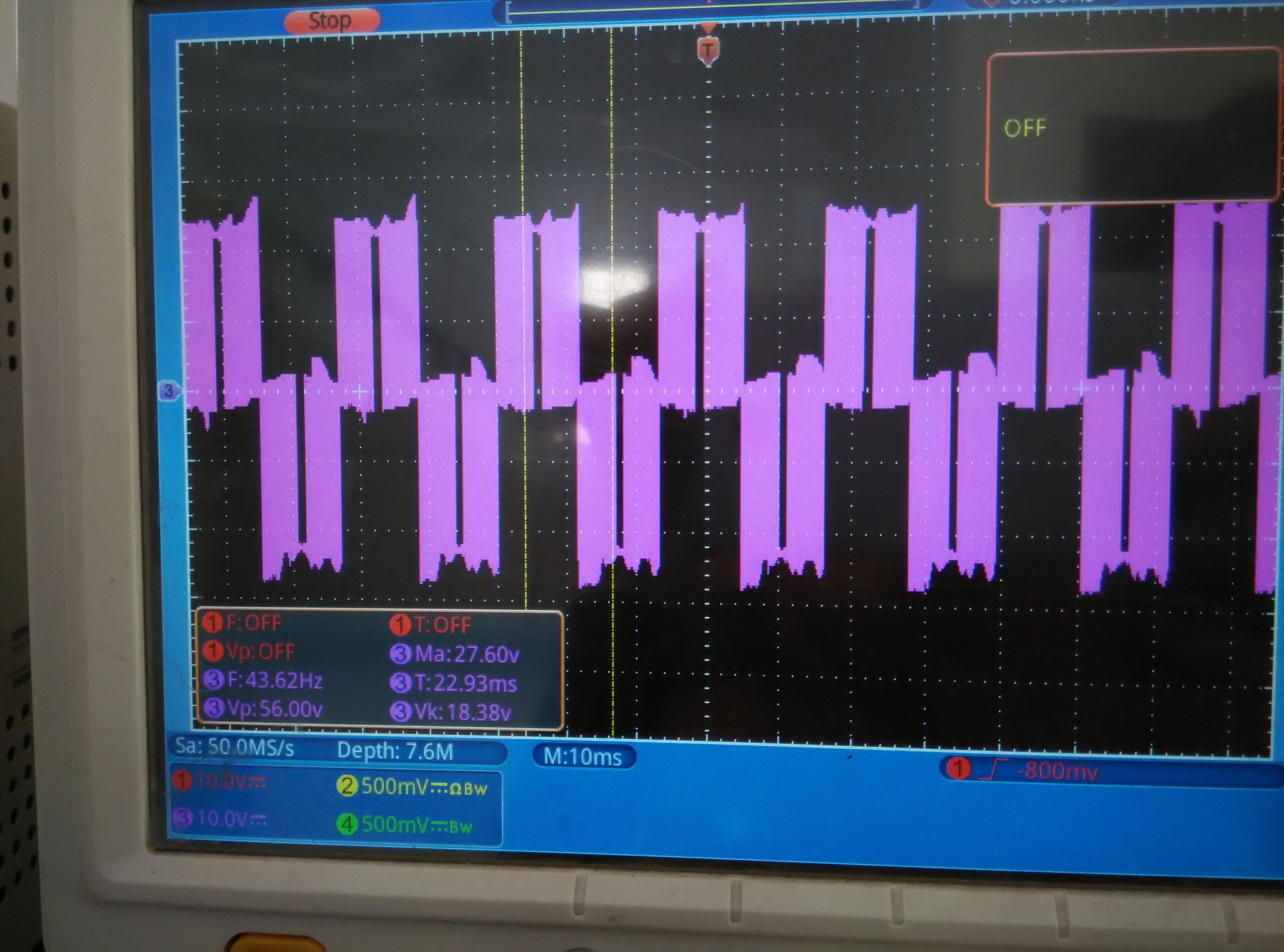

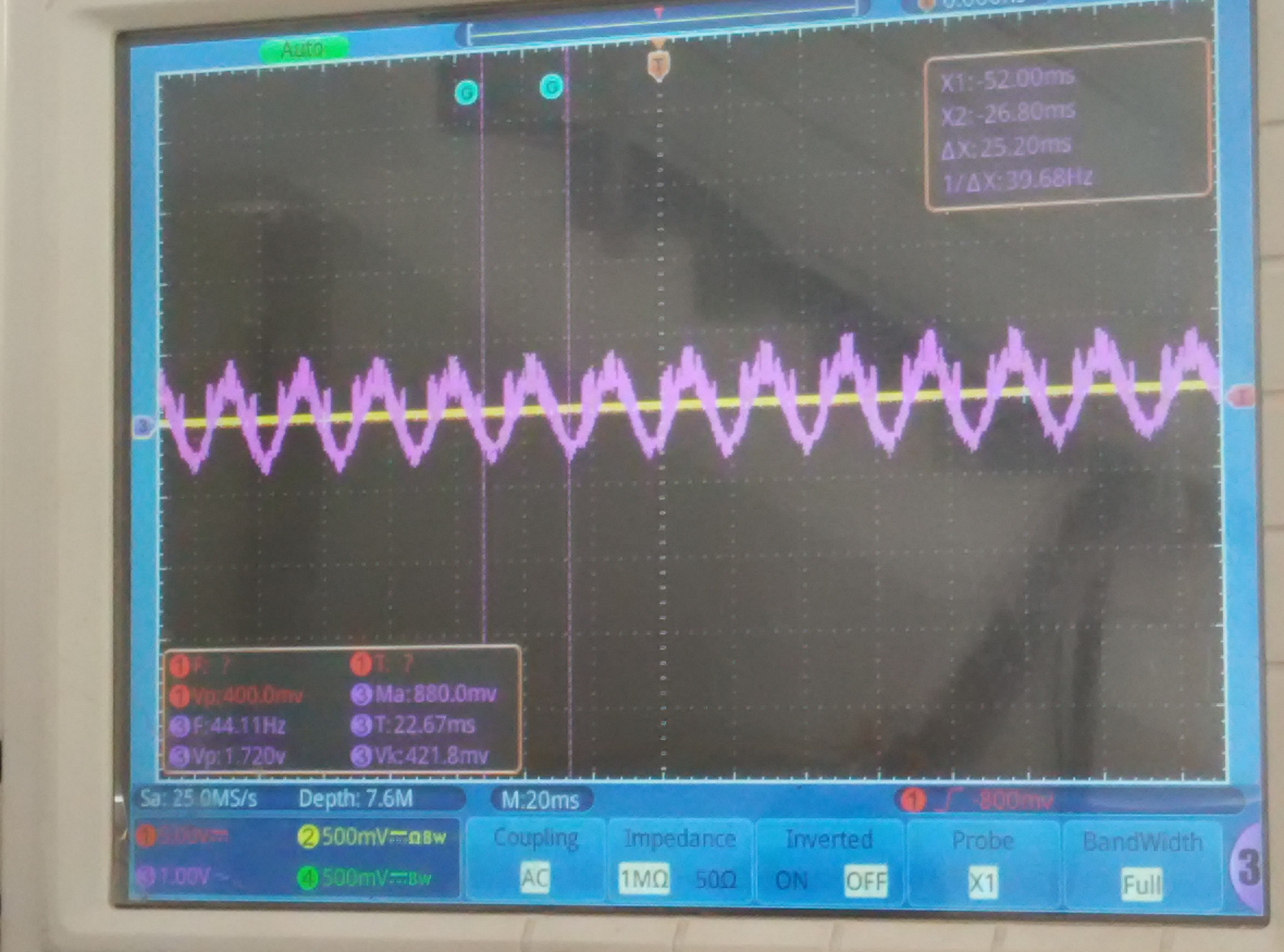

  • Here am attaching wave forms of phase current  ,phase to phase voltage i put 0.3ohms resistor in series to phase w
  • Shurthi,
    Change the adjmode to full cycle in closed loop setting and try to fine tune with control coefficient. Also Reduce dead-time~160nsec.
    Best Regards
