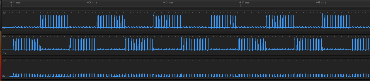

I'm using DRV8833 to create simple waveform. As you can see in following capture (upper one is output and bottom one is input), it is quite unstable. I want to see one straight line but it keeps fluctuating. I just captured one side but the other side of output shows pretty much same result.
Any comment or feedback would be greatly appreciated.
Brian
  • Hi Brian,
    This appears to be due to current regulation, although there is no timescale to confirm it. Please take a look at section 8.3.3 of the datasheet.
    Can you zoom in and provide a timescale on the capture?

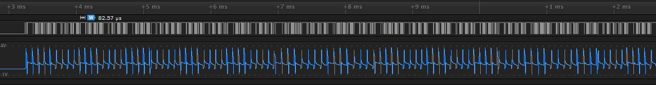

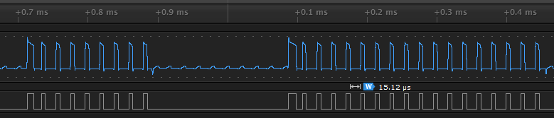

  • Hi Rick,
    Please look below for zoomed capture.
    I used 200m-Ohm sense resistor. Input voltage is near 3V and output voltage is around 3.7V.
    Actually I don't care about the current but higher is better. The load is very small. I used simple coil to create magnetic field from current.
    How should I deal with sense resistor? I used 1Ohm, 200mOhm, and 100mOhm. 1Ohm and 200mOhm show almost same result and 100mOhm was worst. Can you please tell me what could be most suitable value for sense resistor?
    Brian
  • Hi Brian,
    Thanks for the zoomed captured. This appears to be the current control circuit operating as designed. When the voltage across the sense resistor reaches 200mV, the outputs are disabled until the next internal PWM cycle.
    When current control is activated, the outputs enter slow decay. Slow decay minimizes current ripple when regulating current. Depending on the inductance of the coil, there may be little change in the current while the outputs are in this mode.
    At 1Ohm, current control occurs at 200mA. At 200mOhm, current control occurs at 1A. At 100mOhm, current control occurs at 2A. Using a 100mOhm resistor may create overtemperature conditions, which would cause the device to disable for longer times.

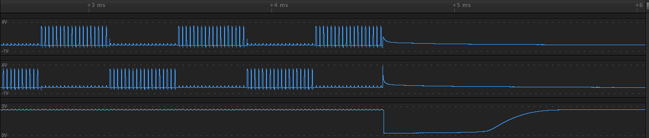

    I captured the two outputs with nFAULT pin. Please look below result. nFAULT never goes up to high and always remained in low. Can you tell me what I need to look to find the reason it stays in low?
    Brian
  • Hi Brian,
    Can you provide your schematic?
    nFAULT should have a pullup. Does it? Without a pullup resistor to 3V, nFAULT is not valid.

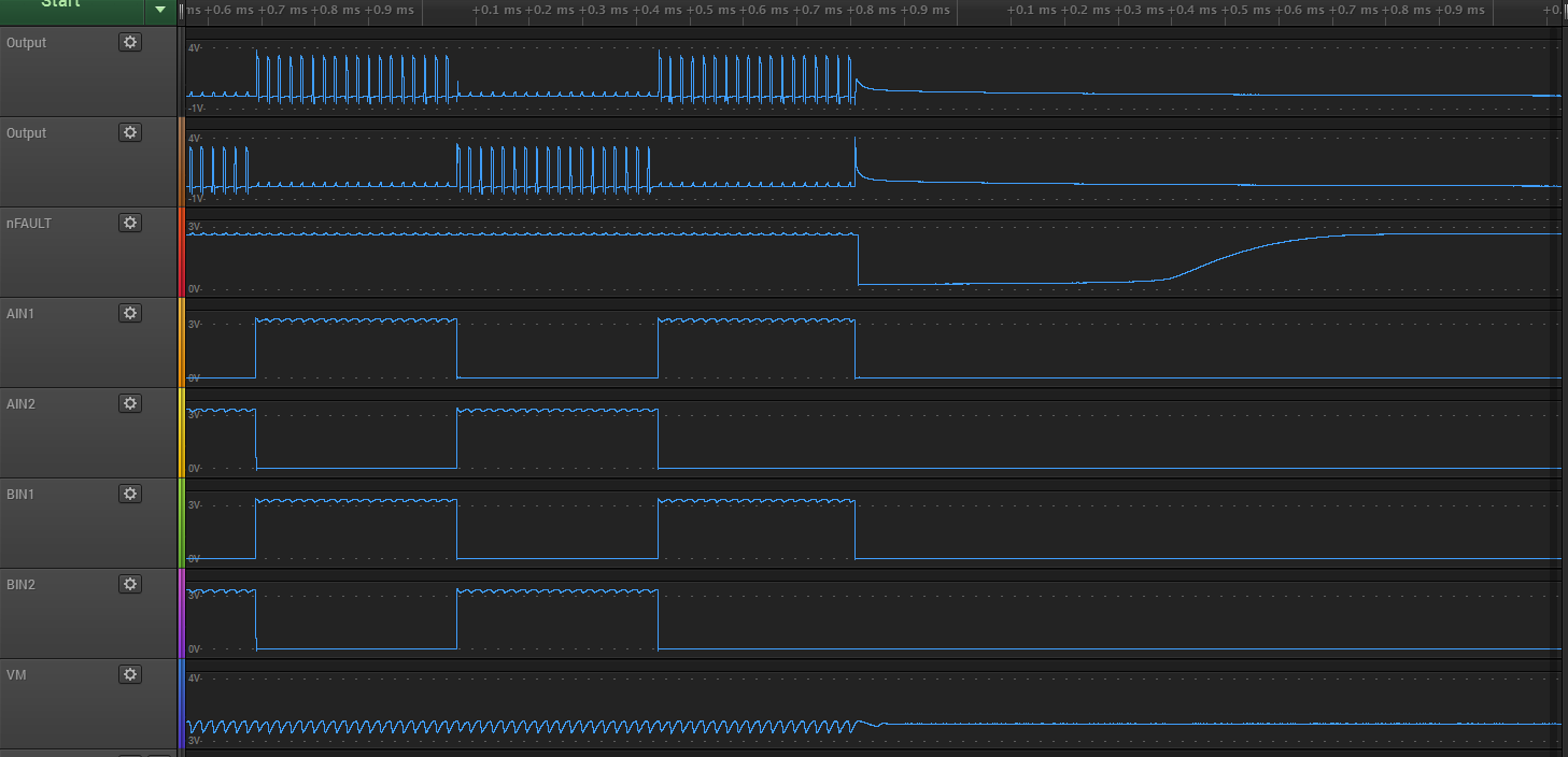

    It seems that nFAULT pin doesn't give me useful info. Below is what I got when I connected nFAULT to pull up resistor. It just shows little bit of fluctuation but there is no drop point except start and end points.
    One thing I noticed was nFAULT dropped even before input wave starts. Do you think over-current already happened even before input was fully given so that all the waveform messed up after that? Can you please tell me what I could try to fix this?
    Brian
  • Hi Brian,
    What is happening at the inputs and VM when nFAULT drops? This will provide clues.
    Have you removed the loads to verify proper operation of the device? This should remove overcurrent and overtemp from the faults if the device is operating properly.
    Can you provide a schematic?
  • Hi Rick,
    Please find the full waveform in below.
    As you see, nFAULT drops in the middle of first input period. There is little disturbance in VM but it stays in high. And here is capture when both inputs goes 0.
    I don't quite understand what the captures mean. If you have any clue what's going on, please let me know.
