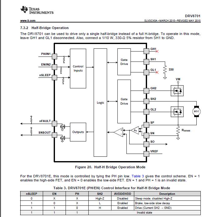

I want to use DRV8301 for TEC drive application. I will use phase A and phase B, but i will not connect mosfets for phase C. When I read datasheet of DRV8701 , I recognized that for unused phases a 330 Ohm resistor is connected between SH and GND. For DRV8301 I need to connect such a resistor? Is it possible to use only 2 phases (Phase A and B) and not connect any mosfet for Phase C?
