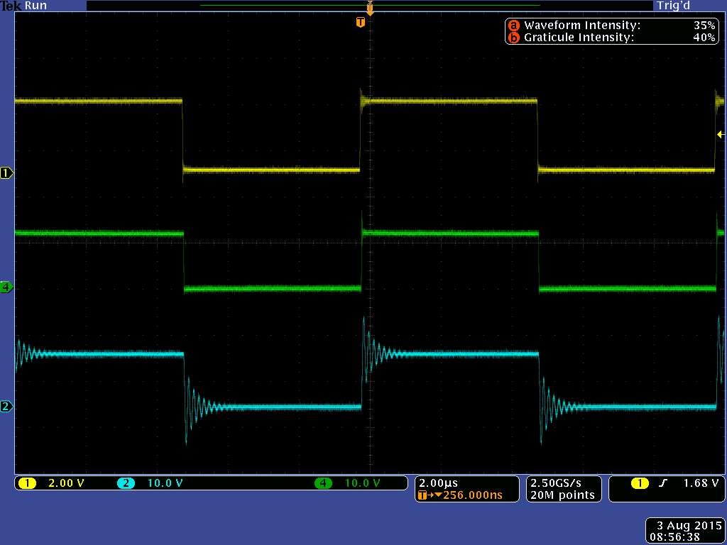

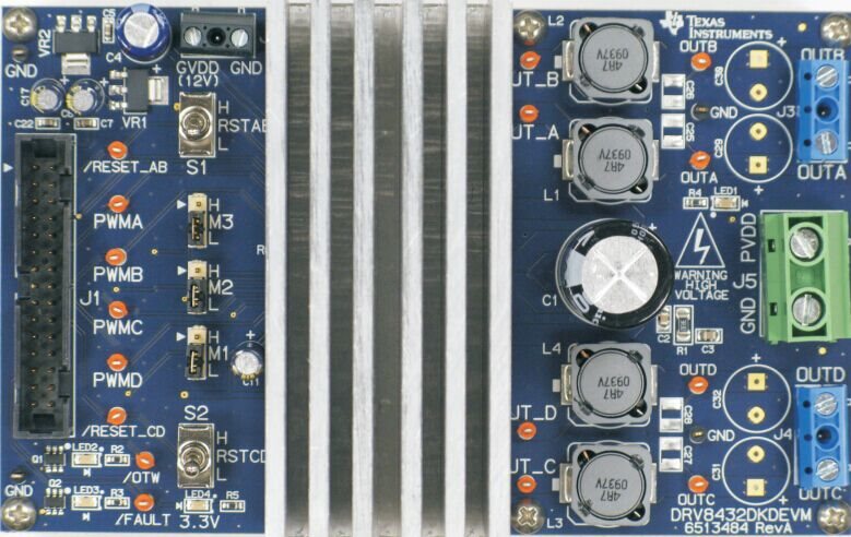

I am using the DRV8432EVM.  I tested it , but I can see big fluctuations of the outputs:
When I disconnect its outputs with anything , I can see many fluctuations. Please see Figure1.

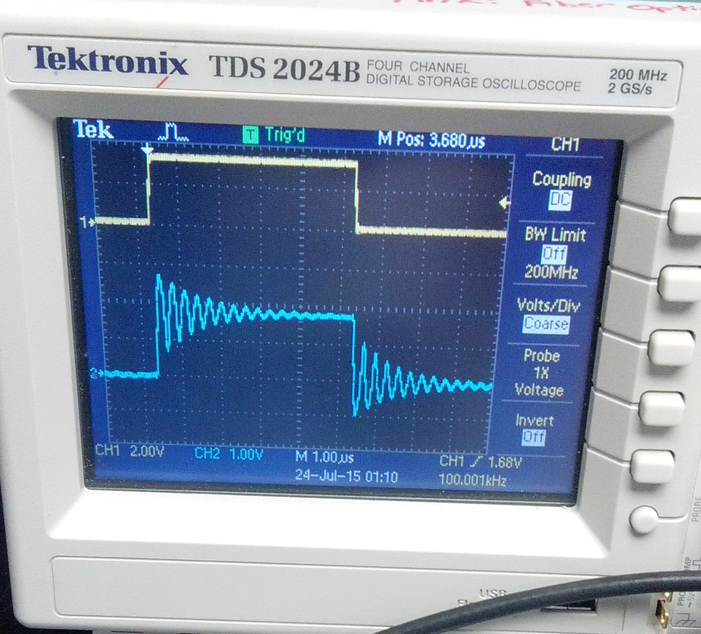

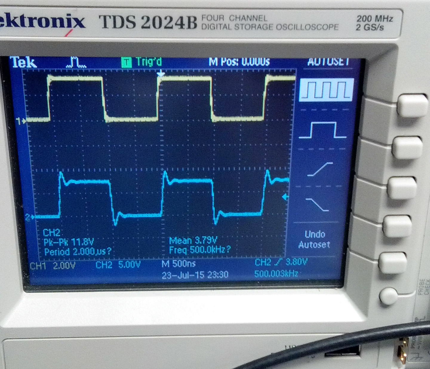

When I connect its outputs with a coil (resistance=11Ω), I can see many fluctuations.  Please see Figure1.

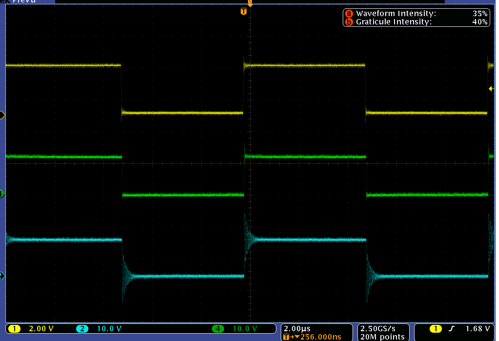

When I connect its outputs with a 200Ω resistor, the number of fluctuations can be reduced to one.   Please see Figure2.

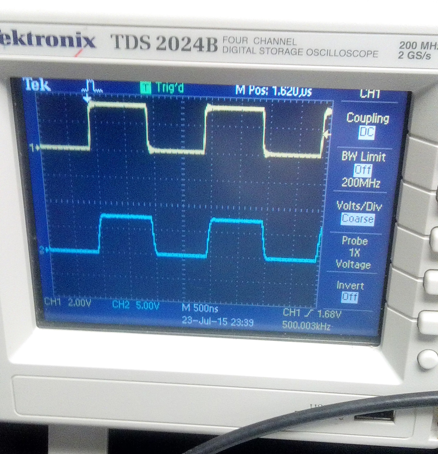

When I connect its outputs with a 100Ω resistor, the fluctuations disappear.  Please see Figure3
 Why the turning on and stabilazing time is not so short as the datasheet says?
figure1
figure2
figure3
