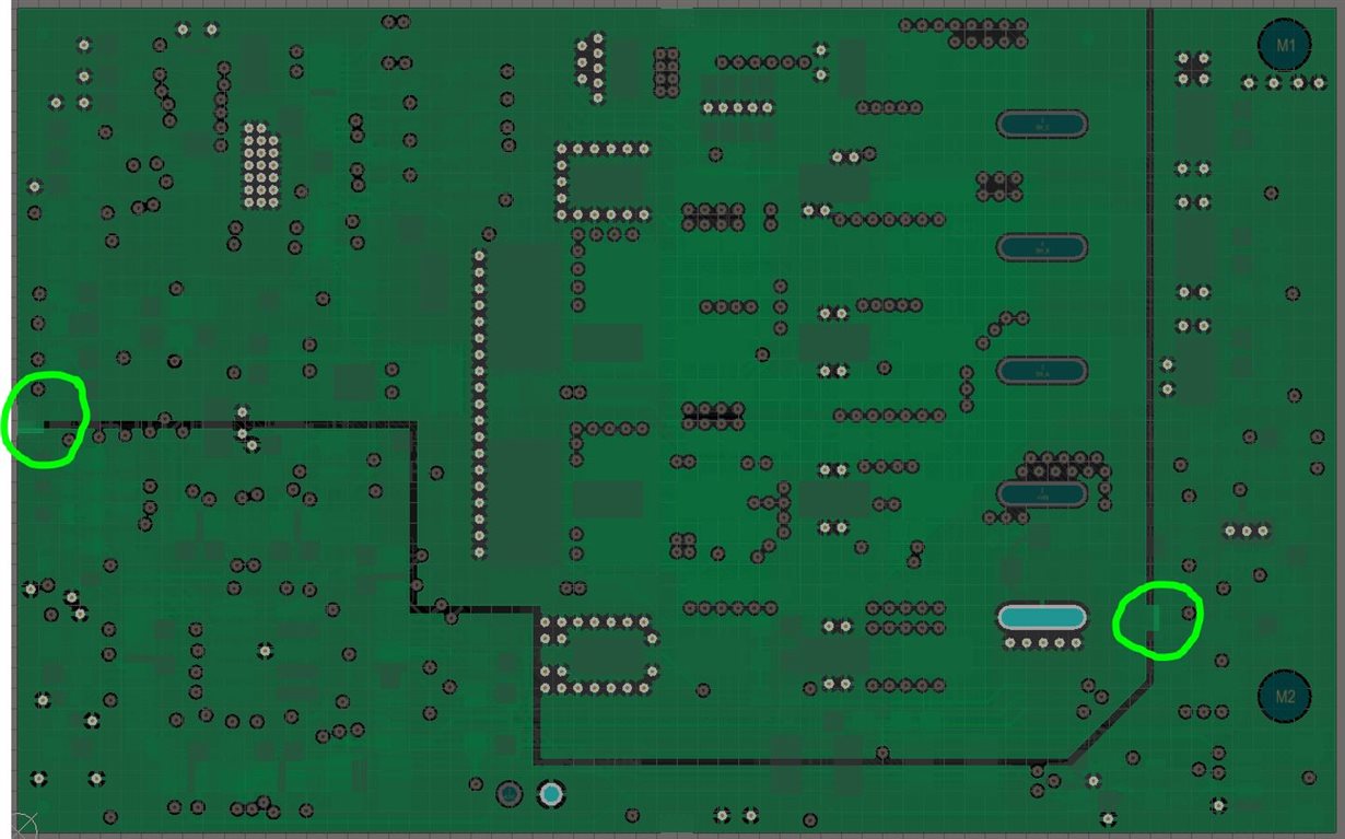

I'm having an odd issue that has cropped up in our latest hardware build using a DRV8301. On our Rev 2 build the controller worked perfectly. Our Revision 3 is a smaller version of the Revision 2. With this new revision when we activate the gate driver we are getting a lot of noise on the 5V power lines and this is coming through in the form of audible noise in the motor. Through a process of elimination I have tracked it back to the capacitor network connected to the COMP pin. If I but a finger on the 39pF capacitor on the COMP pin the noise on the 5V line is eliminated and the motor no longer makes noise. I've tried using several different capacitor values on the C36 and C38 capacitor spots (those values are what is used on the DRV8301 development kit). I'm wondering if anyone has had similar issues and has a recommendations for fixing this noise. Is is possible this is a layout issue? How sensitive is the COMP pin to external EMI noise?

  • Drew,
    Where do the MCU and DRV grounds tie together? I see that there are two separate planes.
    I am worried that a very large ground loop has been formed between the buck regulator (power pad of DRV) and MCU ground.
  • Nick,
    We are aware of the issue on the bottom layer regarding the DRV power pad's connection to ground on that layer. The DRV pad is connected to ground however on three separate internal layers. Do you think that  lack of connection on the bottom layer would be enough of an issue to generate the kind of noise we are seeing? Essentially the current from the GNDs on the bottom layer would need to flow thru the vias up to the ground planes on the higher layers.
  • Drew,
    It is definitely ideal to keep the loop for the buck regulator ground return on the same plane if at all possible. Via inductance will reduce the effectiveness of the bypass capacitor and diode. It is difficult to say whether that is the root cause or not.
    I was actually asking about where the two ground planes for the PCB connect  (high current and low current). Between the MCU ground plane and POWER ground plane. Is it the jumper on Mid-3 near the edge of the board?
  • Nick,
    Yes, they are connected there and on the Mid-1 layer on the left side of the board. There is also a connection near the right side of the board as well on those two layers.

    The noise only happens when the DRV8301 gates are enabled. The noise could be there all the time but when the gates are enabled it is definitely throwing something off in the feedback loop enough to be audible in the motor. I have not yet been able to get those measurements, but I will post them as soon as I have something. Which webench tool are you refeering to? I'm fairly confident that it is probably something layout related at this point. The buck circuits are identical from our REV 2 to our REV 3. Essentially we took the external amplifies off and went down to two shunts instead of three so that we could reduce part count. We also made the board about 2x smaller to fit our application. I'm just a little hesitant to spin another board until we can confirm that it is layout related and not something else like the capacitor values. In your opinion is it better to try and somewhat isolate our analog and digital grounds from the power ground in our layout (obviously we still need to make a connection somewhere because the circuits share grounds) or try and couple them together with larger planes and traces in an attempt to reduce the possibility of ground loops?
  • webench.ti.com
    My personal preference is for a unified ground plane to reduce subtle current loops and then design attention be given to high magnitude and high frequency current paths to reduce noise and coupling. You will hear compelling arguments for both sides though.
