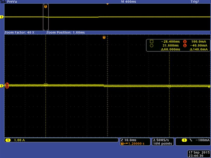

    My first wave form image is phase current.
    I didn't use PWM, so I couldn't see frequency.
    Because motor must do not move when motor is stopped.
    To do that, I shoud don't use STEP / AIN1 and I should use only parameters.
  • "I already controlled TORQUE register value(0x00~0xff). but audio level was same." - Are you sure your change was working?  You should see the amplitude of your current change when you change the TORQUE value and that should effect your sound level.
    "I didn't use PWM, so I couldn't see frequency." - Even when running with the indexer the controller is still using PWM and that is the frequency you are hearing.  Zoom in closer in time on your scope and you'll see the frequency you are hearing.  See that slight discontinuity at the zero crossing?  You need to be on a time scale to show the cycles around that to see how your parameters are defining an audible frequency.  Then adjust your trigger level to look at the top of the sine wave for the best look at the audible components.
    The attached plot shows poor parameters with about a 2 KHz (0.5 ms) audible noise:

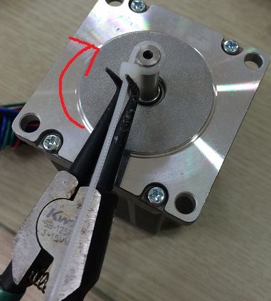

  • I think that you don't understand my mean.
    See the below picture.
    I want that motor does not move.
    Even if I move motor, motor must doesn't move.
    So I didn't give signal (STEP pin) and I changed Register.
    CTRL Register Address = 0x0h (1: Enable motor)
    TORQUE Register Address = 0x1h (0x00 ~ 0xA0)
    I measured current at A phase.
    You can see waveform. TORQUE Register Address = 0x1h (0x00 ~ 0xA0)
    I didn't move motor,  I couldn't see frequency.
    I want reduce audio level when motor stop.

  • So I expect your audio volume increased as you ramped from 0x30 to 0xa0.  Is that correct?
    If so, zoom in farther on that fuzz in your zoomed trace.  A repetitive pattern there in the audio frequency range is your noise source.
    If not, it doesn't make sense you have motor noise.  Is the noise coming from the controller PCB?  You could have a capacitor with a piezoelectric effect making noise.
