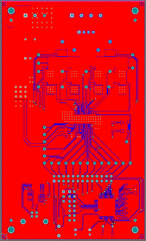

    What is the RDS(ON) and Qg of the external MOSFETs you're using? Can you provide a picture of the board layout you're using?
  • Hi Phil ,
    RDS(ON) = 0.085 Ohm , Qg = 140 nC
    Yes , Board layout
  • Hi Mohammadmehdi,
    Thank you for the picture.
    Could you provide a screenshot of this boards PCB layout from the software used to design it? I'd like to see the ground plane underneath the driver.
  • Hi Phil,
    Excuse me for my long delay
    top layer
    and bottom layer
    thanks for your response.
  • Hi Mohammadmehdi,
    Thank you for the screen captures.  If you look at the ground pour underneath the DRV8711 the path for heat to escape from the package into the ground plane is constricted.  This will cause the die to heat up and eventually flag an over temperature fault.  To solve this problem you need to layout the driver in a way that includes a wide path from thermal pad beneath the driver through to a large ground plane.

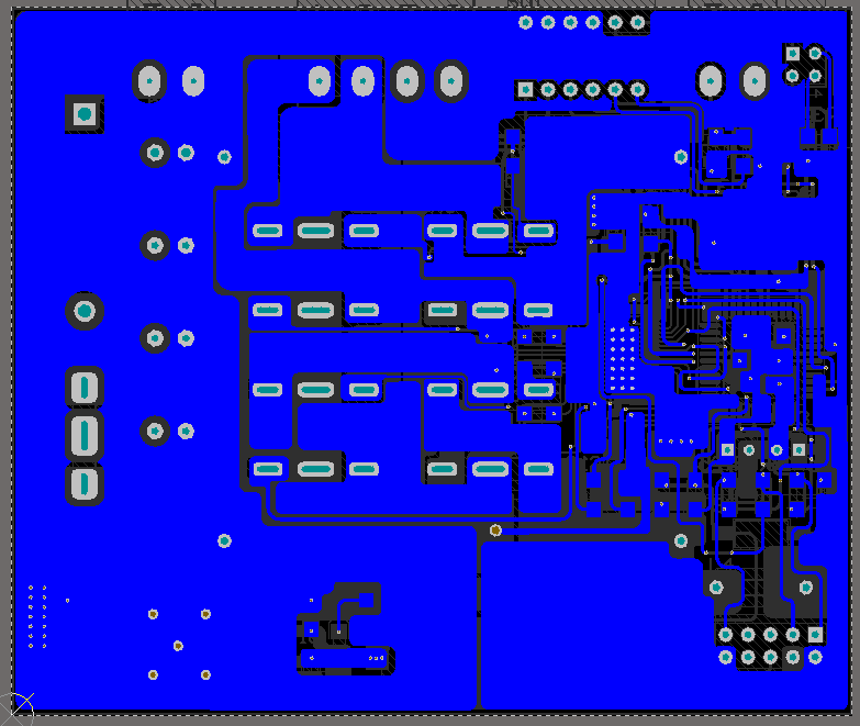

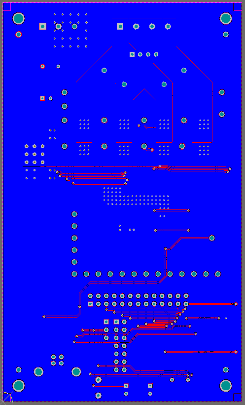

    The Bottom and Top layers of the DRV8711 EVM are attached below, I would advise trying to
    DRV8711EVM Top Layer
    DRV8711EVM Bottom Layer
