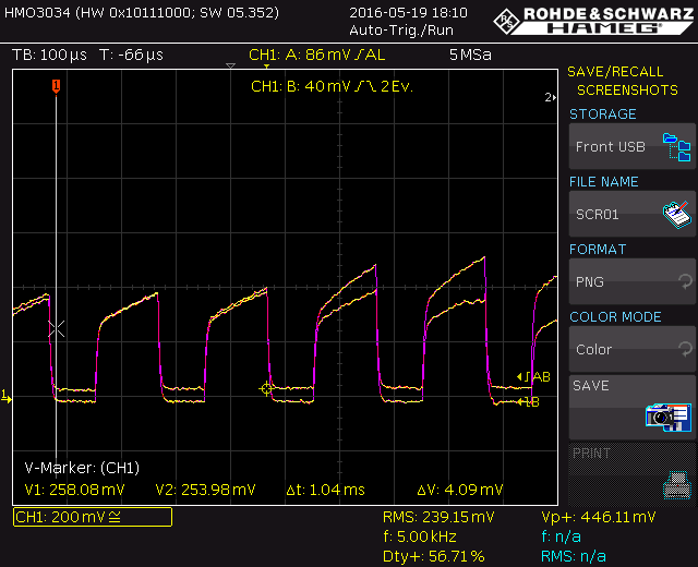

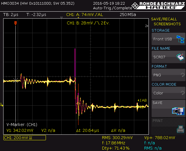

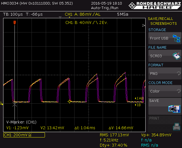

  • Ok i provide this information,  attach the draw, and some scope for now in the Shunt ISEN  ( 0,2 Ohm )  is very strange that in one direction the motor Stop frequently,  i don't know the real peak value, seem few microsecond ....

  • Hi Michele,
    Thank you for the scope captures. Can you provide a few more details?
    What signal is each image? Is there one image that shows the current and the nFAULT?
    To avoid false OCPs, please check for capacitance on the outputs. Placing a cap across the motor can cause false OCP.
    Is the motor stalling after 0,4 seconds? If not the current is normally is decreasing.
  • Good morning, yes sure:
    All the image refer to the Pin 6/9 Rshunt of the DRV8842, in the normal cicle used. The Fault condition is not predictable but sporadic.
    I have do some test and have good news, It seems that some my motors have a light loss versus ground system. I have see that, with a ground connections in the PIN 5/10 or 7/8 (depend of the motor versus) >> sends in nFAULT the DRV8842 after the star cycle!!!, just as happens to me!!
    Now the my system work very better. I have only very rarely nFAULT conditions that appear and disappear very few times.
