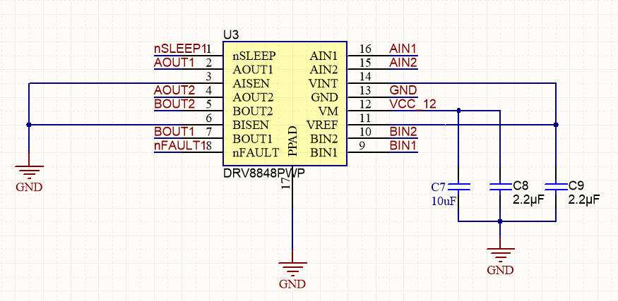

about DRV8848 brake
nSLEEP is logic high voltage
AIN1 is logic high voltage
AIN2 is logic low voltage
VM is 12V power
AOUT1 test result 12V
AOUT2 test result GND
The motor is normal operation
Then
I want the motor Brake
AIN2 is logic high voltage
But then motor is Coast
Why?
  • Hi Haibo
    Is there a SCH can be shown?
    Could you make sure there is parallel mode missing entering. When nSLEEP goes high, the inputs must not be in HiZ input state.
    When you see the coast, what 's state of nFAULT? just want to make sure there is no fault as well.
  • Thank you for your answer.
    I first time to ask questions, do not know how to upload SCH pic
    I make sure it is not Parallel mode.
    "AIN1 AIN2 BIN1 BIN2" is drived by mcu before nSLEEP goes high;
    I will chek nFAULT pin state when the motor coast the near future
