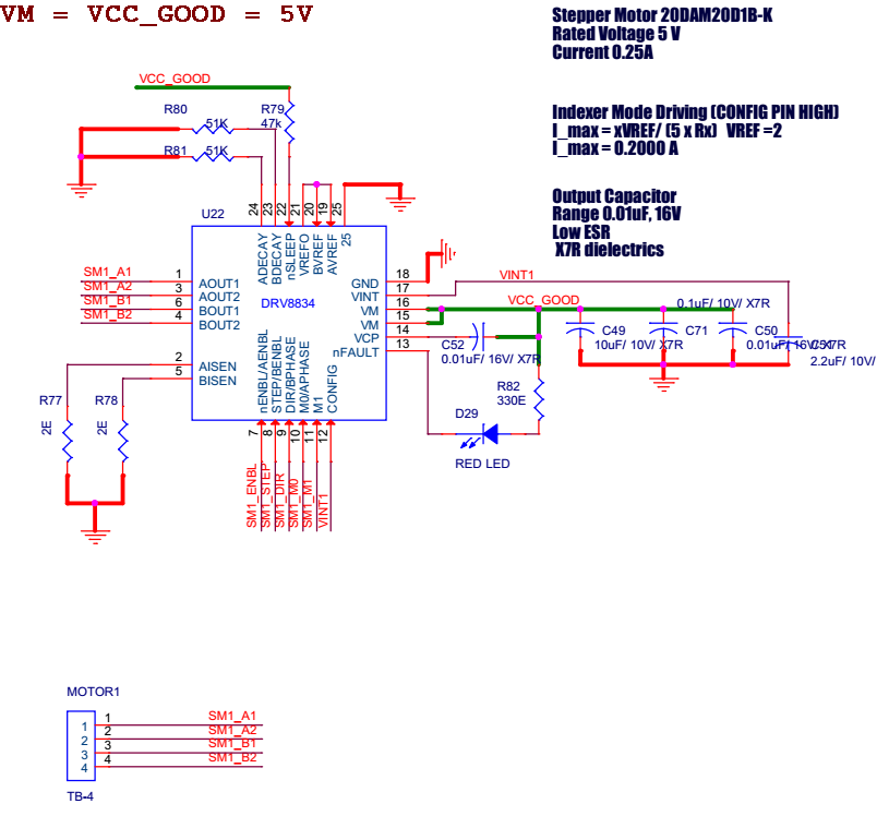

The customer is using DRV8834 at full step mode and their motor will move 1mm per full step. This is working perfectly fine.
However,​they need to achieve 0.5mm motor movement per step. So they are trying to use half step mode, making M1 as 0 and M0 as 1. When they are
​testing this, for the first pulse motor is moving, and for the second pulse motor is not any movement. they found it is working alternatively for ​every ​pulse on half step mode.
​Also when they try 1/4 step mode, for the first pulse motor is moving ,and​ for ​the next 3 pulse motor is not any movement.
What is the reason? How to solve the issue?

    4. What is VM, the decay mode setting, VREF, and the sense resistor value?
    ​ VM is connected to 5V, Resistance on both decay Pin are 51Kohm, VREF is 2V and is shorted with ​BVREF and AVREF. Sense resistor is 2Ohm to limit current to 0.2A (motor rated current is 0.25A).

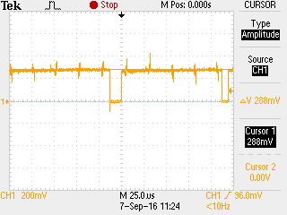

    1.Ideally, use a current probe to measure the current. If this is not available, please capture the voltage across the sense resistor. You may find the average current is less than desired.
    We measured voltage across current sense resistor, Voltage is 280 mV, and sense resistor is 1.8 Ohm, hence current is 155 mA.
    2.Can you try changing the xDECAY resistors to 20K. This will increase the average current. It would also be good to check with the motor manufacturers to confirm the motor can achieve the desired movement. If it cannot, the DRV8834 cannot correct this.
    We changed it to 20 K, and me measured voltage across current sense resistor, it is as attached below
    Voltage is 288 mV, and sense resistor is 1.8 Ohm, hence current is 160 mA.

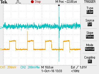

    The customer has sent the   capture across both sense resistors in the same scope capture. Look the attachment.
    Motor_microstepping.docx
  • Hi Mickey,
    Thanks and sorry for the delay.
    Unfortunately, the first three scope captures are zoomed in too much. These scope captures show the PWM frequency of 42kHz, but it does not show the difference in current between the steps.
    The second three provides the desired information. The current below is a rough average based on the PWM frequency and the voltage on the sense resistor.
    First single half step shows 0% in the first coil and an average of 165mA in the second coil.
    Second single half step shows ~80mA average current in both coils.
    Third single half step shows an average of 165mA in the first coil and 0% in the second coil.

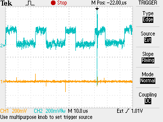

    As suggested we tested with 1kOhm resistor on the decay pins,  but result is same. I have attached scope capture of three 1/2 steps.
    1. Motor is moving for first 1/2 step
    Inline image 1
    2. Motor is not moving for next 1/2 step
    Inline image 2
    3. Motor moves again
    Inline image 3

  • Hi Justin,
    Sorry for the late reply.
    There are two items to point out:
    1) The current regulation appears to be lower than expected. The current chopping should be either at 400mV (200mA) or 280mV (140mA) for a 200mA current. The waveforms show current chopping at 280mV (140mA) and 200mV (100mA).
    2) Without a current probe, it is impossible to determine the average current at each step. This could be the reason for the missing steps.
    I contacted the motor manufacturer. They also believe the current is not being regulated properly.
    If the customer would like to try something, change the sense resistors to 1.1 Ohms. This set the full scale current at 260mA (RMS current per winding of 250mA. This may provide the necessary torque to move the motor properly.
