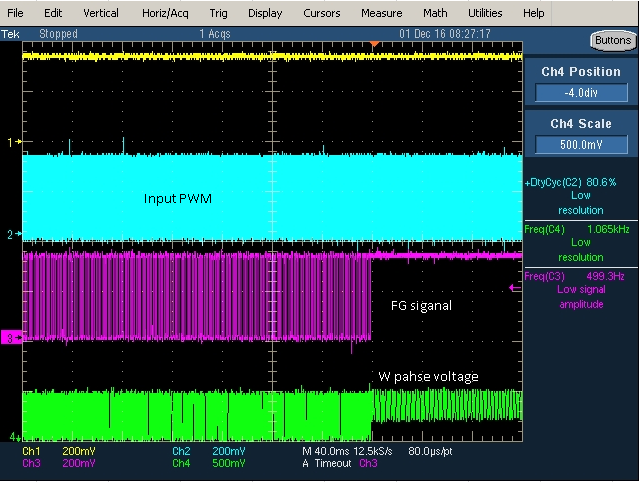

My customer is using DRV10866.
He has a problem.
DRV10866 stops to drive motor suddenly.
Please see the following picture.
(Vcc = 5V)
After stoping driving, DRV10866 can drive normally by system reset soon.
For the reason, I think the cause is not TSD.
Could you give me advice about the cause, please?

    At what speed does DRV109866 stop driving motor ? DRV10866 device has problem of false detection of lock at certain frequency of FG, please see this document http://www.ti.com/lit/an/slva612/slva612.pdf

    Motor speed is 490~510Hz.
    This is FG signal frequency.
    Customer connects FGS and GND.
    Does this condition apply to problem of false detection of lock?
    Shimizu
  • Hi Shimizu-san,
    False lock detection occurs at 101.6 Hz and multiple of this frequency, so it seems like motor speed of 490-500 Hz falls within this range.
    I would recommend to pull high FGS pin ( Connect to VCC) and see if this problem gets resolved.

    [KS] Work around should work under all condition in your case because FG will be around 250 Hz ( half of 500) and it is not multiple of 101.6 Hz

    I think that the internal sampling frequency changes by temperature and for each DRV10866.
    Q1: When die temp is up, Is sampling frequency speed up or down?
    Q2: I think the error range is ±30% from application note.
    Is it correct?
    -> Max:132.08Hz Min:71.12Hz
