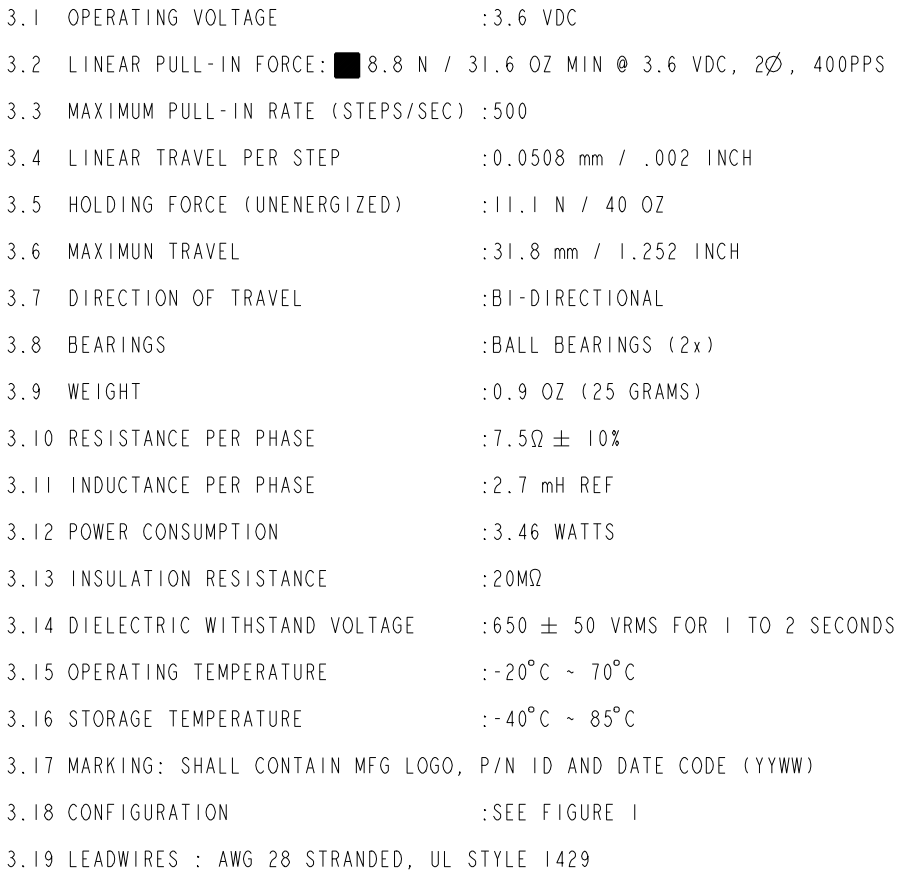

We are making New Design for motor Driving.
We want to drive Stepper motor with the use of DRV8834 and below detail mention stepper motor Specification.
Can we drive this motor using DRV8834?
If yes provide some reference Design.

our system voltage will be provided by battery li-ion 3.7v DC.
yes there are many driver available in TI but this driver has more features compare to other driver.
we are finalized this driver IC.

Our stepper motor specification and supply source was mantion abow.
We are use capacitor for motor voltage is 10uF(electrolytic) and 0.01uF .
So this both capacitor is enough for the power suply of drv8834?
Hi Haresh,
The values are a good starting point, but should be monitored during operation to determine if the voltage variations are acceptable.
