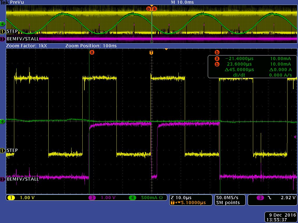

I'm seeing some strange behavior on STALLn / BEMFVn pin 19 with 256 microsteps.  In my scope screen shot, purple is the STALLn/BEMFVn pin.  You can see it transitions active low twice within 45us.  In this example I'm running at 50 RPM which, for my motor, is 42,666 pulses per sec or 23.4us per pulse.  That being said, it looks like the DRV8711 is rearming and signalling back-to-back BEMFVn measurements after the zero current step.  What would cause this?  Am I pushing up against the frequency limit of the DRV8711 by trying to run at 42.6kHz?  I don't think I'm even close to the frequency limit because the spin guide talks about running upwards of 400kHz.
If I double the speed so it is 100 RPM, the behavior doesn't change except the two active low transitions occur in half the time.  In my scope screen shot, the yellow signal is my SPI clock which is clearly staggered in-between each zero current step, so I'm convinced the double active low transition on the stall pin is not due to me reading/writing to the DRV8711 STATUS:SDTLAT bit to clear the SDT bit and STALLn / BEMFVn pin, in preparation for the next back EMF sample.
This double active low edge on the STALLn / BEMFVn pin is causing problems in my system because I'm running in external stall mode so my microcontroller is taking BEMF measurements every time it sees an active low transition.  I'm using the measurements to adjust torque, so having two adjustments in one step is not ideal for my application, especially since the measurements can not be accurate since one of the active low transitions spans outside of a zero current step.  If I change to 128 microsteps but keep the speed at 50RPM, I get a single active low transition at each zero current step like I would expect.  Below I have include a second screen shot which shows the STALLn pin (purple signal) in relation to the STEP input (yellow signal) at 256 microsteps 50RPM.
1.) First screen shot: YELLOW = SPI Clock from Microcontroller, PURPLE = DRV8711 STALLn / BEMFVn, GREEN = Current Probe on Motor Coil
2.) Second screen shot: YELLOW = STEP input to DRV8711, PURPLE = DRV8711 STALLn / BEMFVn, GREEN = Current Probe on Motor Coil

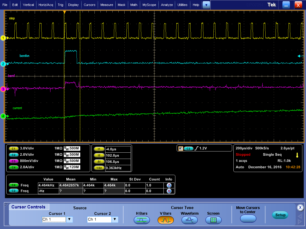

    At the current 42,666 pps,the results from the BEMF is not valid. If the step pulse is less than ~110 us (this may vary depending on the motor), the current is not sampled properly. You can see this in the following images.
    At 8k pps, the BEMFVn signal drops before the next step pulse indicating the sample is valid. The first image is zoomed out to show that BEMFVn occurring at the zero and 100% current (zero current in the winding not shown).
    This image is the zoomed in version of the one above (8k pps) to show that BEMFVn is asserted prior to the next step pulse.
    The image below is the zoomed in version at 12k pps to show that the BEMFVn is terminated at the start of the next step pulse.
    The image below is the zoomed in version at 24k pps to show that the BEMFVn is terminated at the start of the next step pulse.
    To achieve valid back emf information, please try lowering the microstep rate such that the pps are approximately 8k or less.

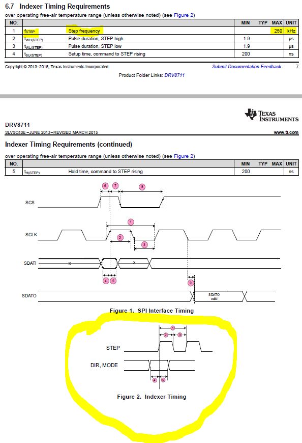

  • I see what you mean.  From your scope captures, it looks like the DRV8711 must be given enough time to transition BEMFvn signal low again before the next step occurs, otherwise the measurement is invalidated.  8k is pretty slow though and in the audible range for human hearing.  The only way to achieve a pps lower than 8k for our motor running at 50RPM would be to reduce to 32 microsteps.  This will be much noisier.  We prefer to run 20kHz or higher to minimize audible noise and provide smoother operation.  In the DRV8711 datasheet it says the maximum step frequency is 250kHz.  I don't see mention of 8kHz limitation you speak of--why?

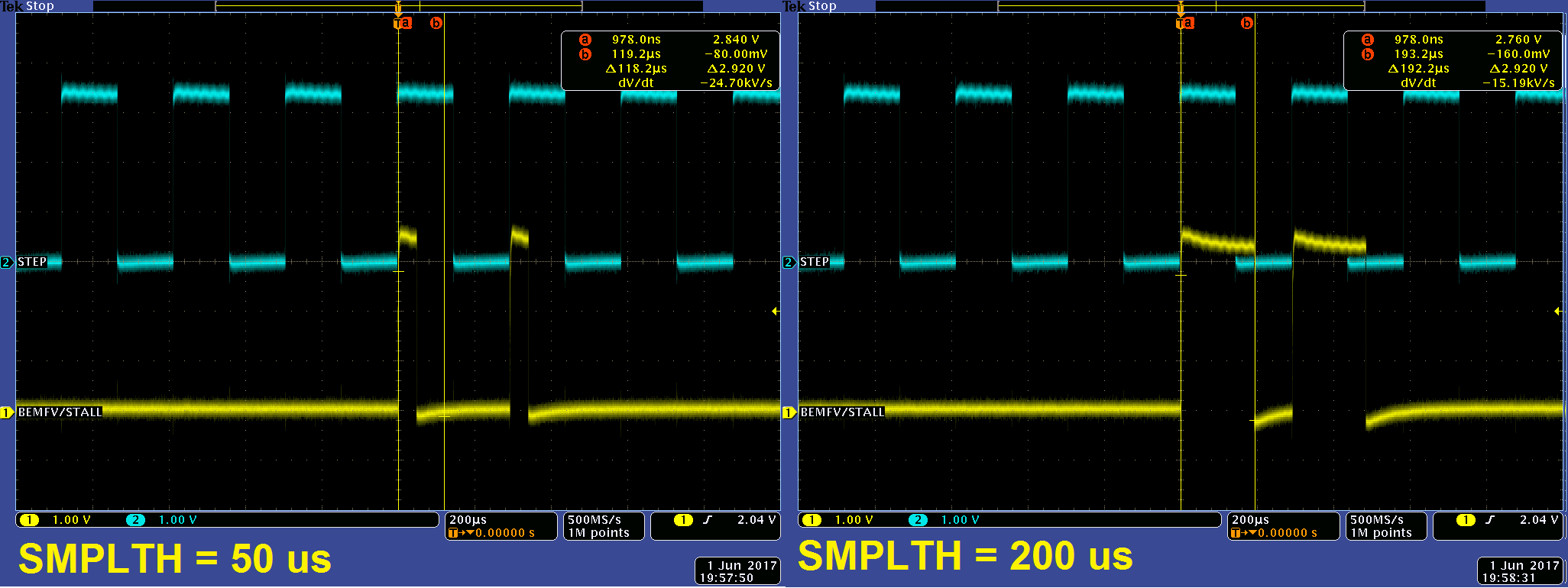

  • Despite having a step frequency of ~3,413 pulses per second (~292 micro-sec pulse period), I am still having issues with the stall pin giving two pulses at every zero current step.  This is about 4 RPM with my 200 step/rev motor.  Your previous post said to keep the STEP pin period more than 110 micro-sec so because this example is much more than that, I should have an accurate BEMF measurement.  You said the 110 micro-sec limit can vary depending on the motor but, I see the same behavior without the motor connected.
    I am not writing to any bits in the STATUS register so I'm expecting the STALL pin to assert and clear itself.  According to the data sheet, the STALL pin is active-low, so I'm expecting to see a voltage equal to VCC when the BEMF measurement is ready and GND otherwise.
    Interestingly, I only see the double pulse when CTRL[MODE] is set to 256 micro-steps.  If everything else stays constant and I just change CTRL[MODE] from 256 to 128 micro-steps, the STALL pin works as expected -- only one pulse every zero current step.
    Although it might be unrelated, I want to point out that the only register write that seems to effect the timing of the double pulse is TORQUE[SMPLTH].  This screen capture shows the STEP pin input in blue and the BEMFV/STALL pin output in yellow.  The image on the left is when TORQUE[SMPLTH] = 50 micro-sec (the minimum) and the image on the right is when TORQUE[SMPLTH] = 200 micro-sec.  It seems that the width of the pulse changes according to how TORQUE[SMPLTH] is set which is what I would expect.  I don't think this has anything to do with the problem but all other register writes (besides CTRL[MODE]) do not have any effect on the double pulse.  That being said, this is starting to appear to me like a quirk with the DRV8711.  Any thoughts?
