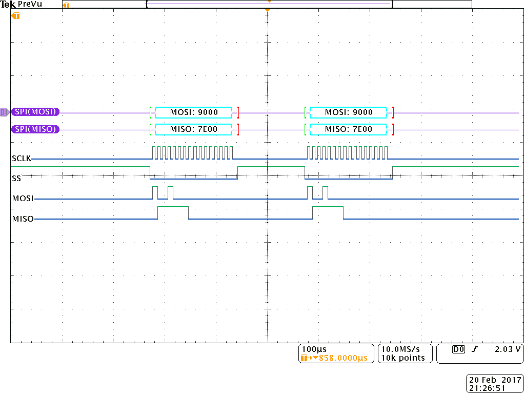

I am currently working on a BLDC motor controller project using the DRV8301. The chip works great, except I can quite seem to be able to correctly communicate with DRV8301 via SPI. While I am receiving data back on the MISO line, the data does not make much sense to me. Figure 1 below shows a screen capture of the communications.
Two Frames of SPI Data
The MISO reply from the DRV8301 is 0x7E00. One part of this response is promising, no frame error bit (bit 15)! However, the reply states the address (contained within bits 14:11)  is 0x0F. This doesnt seem to be possible since the DRV8301 only has 4 registers (addresses 0x00 to 0x03). What is equally worrying is that no matter what address I request in the previous MOSI frame, the DRV8301 replies with same confusing message.

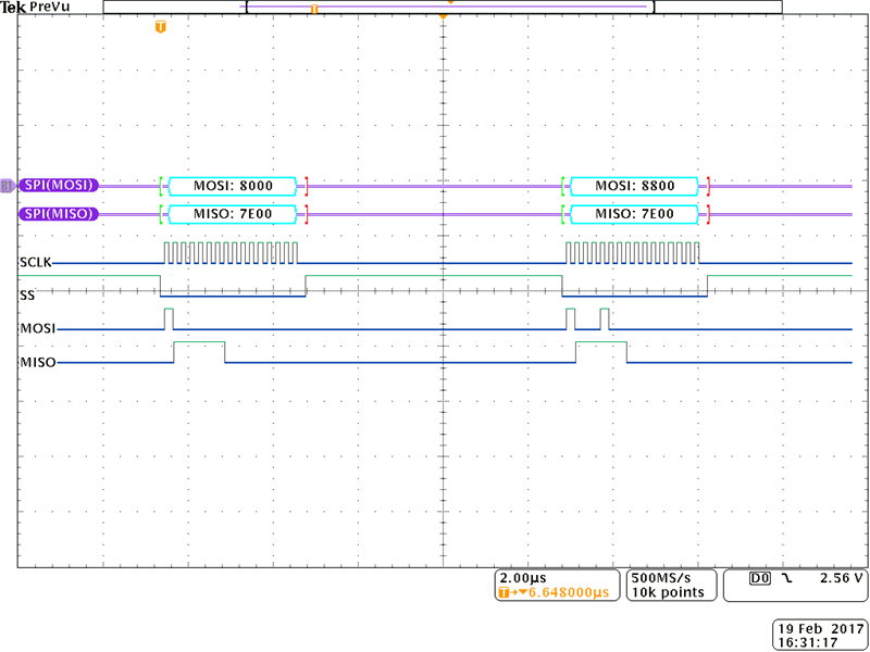

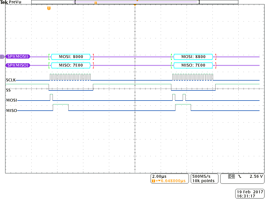

    When I first encountered this issue, I also slowed down the SPI bus. The results were no different. However, I figured it would not hurt to slow it down again to help rule out timing issues. Below is a screen capture of what I am getting when I slow the clock down to 100kHz (instead of 5MHz) and only request control register 1 (Address 0x02).
    As you can see, the results are the same. Instead of the last 11 bits being 100 0000 0000, they are 110 0000 0000.

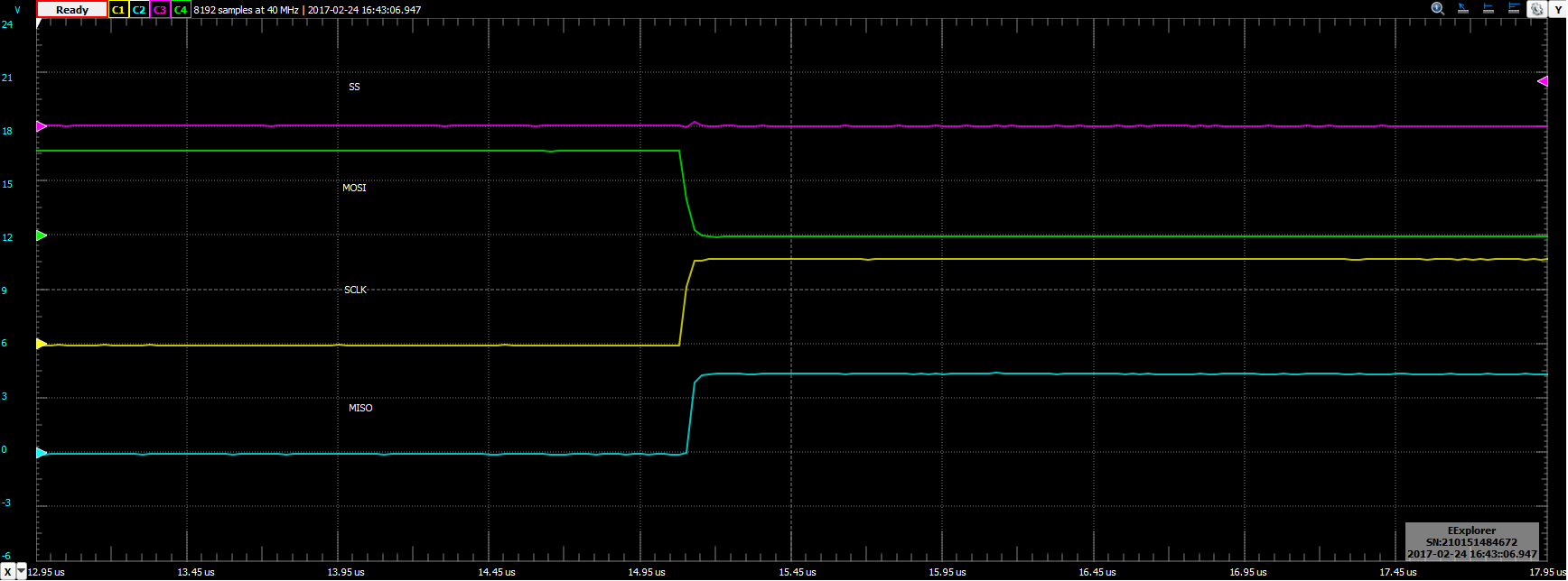

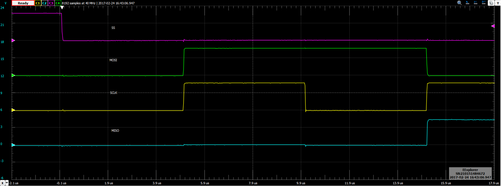

    There is one more item to try. Please zoom in to see the rising and falling edges of the SCLK and other signals at the DRV8301. Do the rising and falling edges rise then dip or fall then rise before reaching the final logic level?
    Please let us know the results from the second populated board.
  • Rick,
    Below are two different screen captures of the rising and falling edges of the signal. These screen captures were taken on one of the new boards I assembled. The signals do not seem to rise or dip in any significant way, but maybe you might be able to catch something I am not seeing. I have also reduced the slew rate of the microcontroller pins to limit the effects of overshoot on the lines. There was no change.
