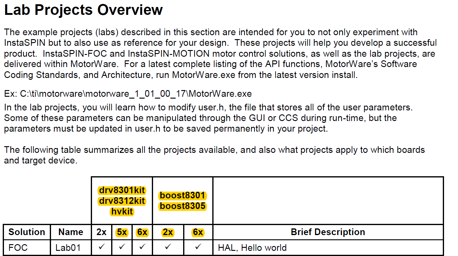

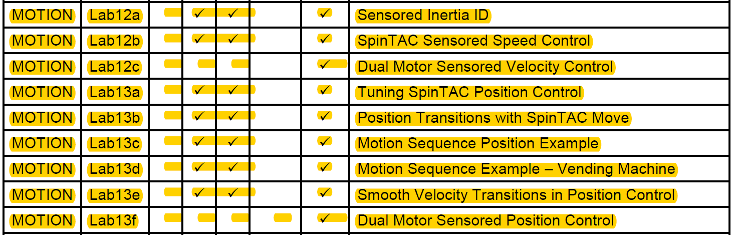

    I have been reading some INSTASPIN labs and found a solution section for MOTION. Now, the example projects found for these solutions, which can be seen in the images attached, are all for driver solutions with external FETs, as all these labs are example projects with the INSTASPIN-MOTION code implemented for them. The User Guide for MotorWare can be found in this directory after it has been installed:
    C:\ti\motorware\motorware_1_01_00_15\docs\labs\instaspin_labs.pdf
