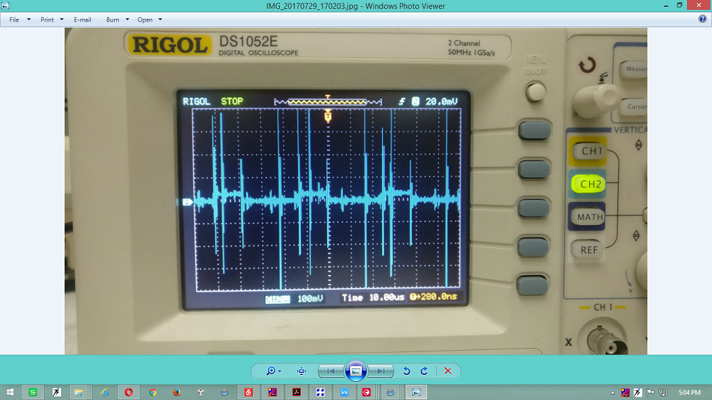

  • Hi Rick,
    Thanks for the Quick reply.
    I am doing all the trial on your BOOSTER PACK DRV8711 board  by replacing the launch pad with a LOW COST micro controller. The motor is rotating fine but I need the wave form for tuning different motors.
    I have connected VINT pin directly to SLEEPn to enable the device automatically on power up.
    I don't have a current probe, so connected the scope voltage probe across the sense resistor (.05R) node, which is connected to BINSENP pin .  Please see the capture image taken when the motor run in low speed (12 pulse/sec) in FULL STEP.
    I have not changed any register from its default value except the two
    TORQUE Reg=0x0110
    CTRLreg =0x0C01
    I can take the capture by connecting to the  pin "AINSENP" . should I send the capture for AINSENP?.

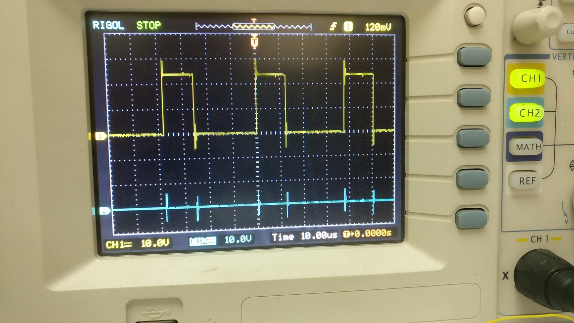

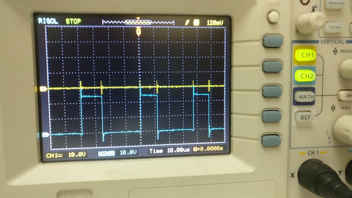

  • Hi Rick ,
    Please see the AOUT1& AOUT2 scope captures in chanel1 ,Chanel2
  • Hi Biju,
    I suggested the other devices because they can reduce the system cost if your current and voltage needs are met. The devices have integrated FETs. I understand now you have higher current demands which are pushing you to the DRV8711.
    Thank you for the scope captures. This shows that you are regulating in slow decay, but does not show the current. The current can be calculated when Channel 1 is high and Channel 2 is low, or when Channel 2 is high and Channel 1 is low. The voltage across the resistor divided by the resistance provides the current value. Once both output are low, there is no current information.
    If you can gain access to a current probe, you will find it much easier to measure the current.
  • Hi Rick,
    You are right .It is difficult to measure the voltage at the sense resistor using scope, but I tried using a volt meter and  it shows 8.4mv at all the full step positions.
    An ammeter in series shows the winding current as  0.53A.  But I set the Toque reg for .48431(IFS=0.6821A) Is this  small difference is normal?
    Please not the modified Torque and CTRL values for the same.
    TORQUE=0x017F
    CTRL=0x0F01.
    I found one another issue related to home position . The winding current the is not as per the table explained in the data sheet. It start from zero at home position in 1/2 step mode.
