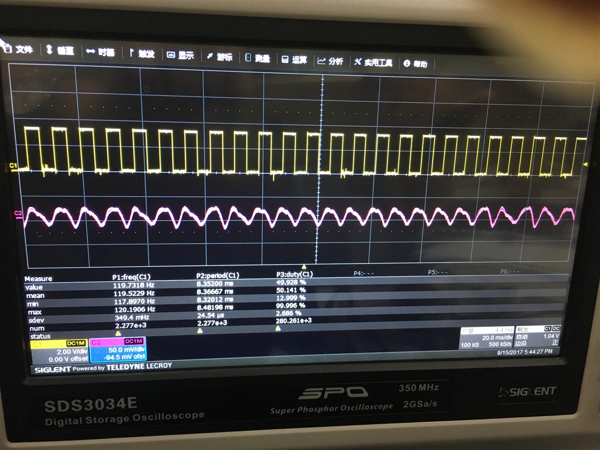

1: Open close running can not  arrive maximum speed .
     speed cmd buffer 22%    ,  speed command :100%
2:  current wave is not correct  at  300 speed  when close loop running :
but ,  current wave is good when speed at 300 when open loop running:
3: analog input  can not  available when unchecked OVER-RIDE box:

    fourth:  wave problem :  for ZWL 12-22-2.5I Motor ,   kt=12VDC*15/2800rmp=64mv/HZ   R=1.5   LR=0.5MA  INERTIA =50MS    these parameter i tested  according SLOU395D
        when motor running maximum speed , the wave look very well . but  when it lower than 511,    such as 300 speed the wave is not sinusoidal ,

    about current wave,  you didn't  mention it . but we need help , because , when motor running lower speed  ,   there noise be heard.   in low speed , current wave show abnormal form as you see.
    How can i do when low speed control ?
