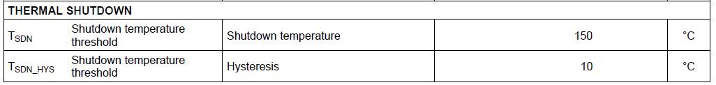

customer needs to monitor the motor temperature. Is it possible to connect a temperature sensor to the DRV10983 in case he wants to run the DRV10983 standalone.

Hey Holger,
While the DRV10983 does have the option to see if the junction temperature is over the "Shutdown Temperature Threshold" shown below, unfortunately, there is no way for the user to directly sense temperature using the device or attaching a sensor to the device.
