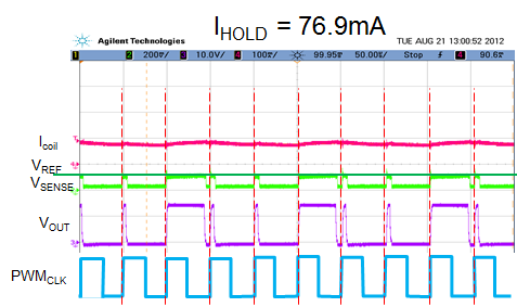

For testing purposes, I went with the default values of ipeak and ihold by using 0 ohm resistors at rpeak and rhold.  When I enable the device, I here the solenoid engage, and the DRV110 switches over to the hold mode.  The solenoid remains engaged, but if I look at the gate of the FET, I see a somewhat erratic waveform.  I would of expected to see a waveform with a well define duty cycle, but I do not.  The duty cycle is constantly changing with no apparent pattern.  Is this normal?

    2) A non-uniform PWM is normal under certain circumstances. It is key to look at the current of the solenoid though. The part is keeping the current at the level you are setting but to do that it may have to vary the PWM duty cycle. I'll point you a different post where another person saw two different strange phenomenon that are actually the part working properly. I go into the full explanation in my second and third response (e2e.ti.com/support/applications/motor_drivers/f/38/t/641857) . Short answer is that yes it is normal. To see a stable PWM signal on the gate, at the frequency you set, the current through the solenoid has to rise to the set value and then fall out of the hysteresis window in one cycle. When fpwm is running faster than that it may have to vary the duty cycle to keep the current where it is set because of how it checks the current.

    1) The gate signal having a varying duty cycle is usually okay. I would recommend looking at the current through the solenoid on an o-scope, if possible, to see if there is a lot of ringing when the FET switches. If there is ringing it could be causing the sense comparator to falsely trip. My recommendation for that is farther down in my response.
    If you don't see ringing you usually see varying duty cycle when the current doesn't rise and fall to the same point in one cycle. A constant duty cycle means the current is rising to the peak and then falling out of the hysteresis window in one cycle. If you are looking at the FET gate, during the high period it rises to the peak and then when it's low the current falls out of the window to the same point every time. When you see a varying duty cycle the current isn't rising and falling to the same point. Usually the way it goes is:
    1. FET Gate high, current reaches peak.
    2. FET gate goes low, now no current can be sensed, current drops close to the outside of the window.
    3. Next cycle FET gate high to sense current. It turns on for minimum 8%. The current rises a little bit while it's on, but it sees the current isn't outside of the window so it shuts off for the rest of the cycle.
    4. Next cycle the FET turns on and sees that the current is far outside the window so the FET gate stays high for close to 90% duty cycle or even multiple periods.
    An example of this sort of behavior is below:
    This one is pretty uniform with one period high for a long time then two minimum on-time periods on the FET gate (Vout). But this is the sort of thing you can see. The first cycle the current is high enough so the FET stays high for its minimum on time then shuts off the rest of the period. Next cycle it turns on to check the current and sees that it still isn't low enough so it stays on for its minimum on time and then shuts off the rest of the period. Next cycle the gate goes high and the sense pin sees that the current has gone outside the window. It has to stay on for ~90% to get back to its set point, then this whole thing repeats. The FET gate looks a little strange with the varying duty cycle, but the current through the coil is fine. It's just the part doing its best to regulate the current. To do that it may have to vary the duty cycle.

  • Hi Kevin-
    The example waveform in your last email is very similar to what I am seeing although the longer cycles are not quite as uniform as depicted.  I see the minimum cycles followed by longer cycles of varying on times.  As you mentioned, I guess it is the device trying to do the best it can to regulate the current.
